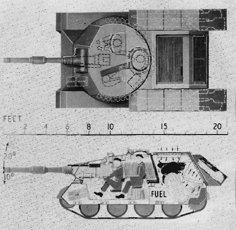

Not quite. The T92 was arguably a better vehicle overall, but was passed over because it wasn't amphibious, ironically, since the M555 rarely used that capability in service. Not to mention that the army brass was enamoured with the concept of using a missile capable 155mm gun. However, the Sheridan did prove to be pretty useful during the Cold War, despite it's shortcomings.

The vehicle would have been far superior had it mounted its originally intended armament which was a long barrel 76mm similar to that of T92. 90mm was also studied, and so was a lightweight 105mm. An 105mm L7 seems to have been too big. For a lot less trouble a 76mm or 90mm gun could have been placed on an M113, as several nations have done, to create a barely protected scout vehicle. As it was the US Army was lucky that the price inflated so much only about half the intended buy was actually built. Its kind of telling that they were withdrawn from all units except the 82nd Airborne by 1978 after not even ten years general service,and before the M1 tank or M2 Bradley were even available.

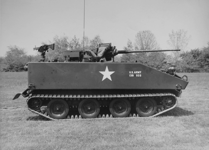

The Australian M113 Fire Support Vehicle (FSV) was initially built to provide mobile fire support base and convoy protection in VietNam to free up the Centurion tanks for offensive use. While the FSVs were being built we used M108s (the 105mm version of the M109) in this role. The Australian Army had wanted an airborne light tank to provide the Medium Recce Vehicle (MRV) capability to our cavalry regiments and trialled the M551 for this role in the 60s. It was found to be not up to minimum combat standards for the reasons outlined above. In its place additional M113 hulls and Scorpion turrets were purchased to make more FSVs for the MRV capability. But this was always considered a sub optimal solution because there was no acceptable ABCA light tank available at that time (the Scorpion being judged as too small and petrol powered for the Australian Army). The T92 would have been a much better solution for Australian needs.

Food Machinery and Chemical Corporation did develop the M113 1/2 Lynx command and recce vehicle based on a shortened and shallower M113 hull. The biggest difference is that the engine is mounted in the rear and one of the few new parts is a drive shaft connecting the rear engine with the front final drives (ala. Sherman). FMC sold hundreds of Lynxes to Canada and the Netherlands. They left the factory with Browning .30 and .50 calibre MGs, but the Dutch later upgraded theirs to 20 mm cannons in a new one-man turret. Both NATO nations eventually retired their Lynxes, but ex-Dutch Lynxes still serve in the Chilean and Bahrain Armies.
The US Army did develop the completely new M114 tracked recce vehicle, but it was a dud.
It should be noted that the Canadian Special Service Force air dropped both the M 113 and the Lynx during more then one exercise during the 80s.
You have to admit though - it is a somewhat elegant idea. You get the short range demolition power of a heavy artillery round, combined with a completely internal (and reloadable) missile launcher capable of killing any existing tank (with with reasonable growth potential due to a fair sized bore). Of course, a limited rate of fire, small amount of ammunition and low muzzle velocity (requiring one to get in close) are problems for the main gun and the missile system has the long flight times the plague all sub-sonic missiles. The addition of 30mm weapons rounds out the BMP3's weapons array (with its large number of rounds) - otherwise it is a similar approach to getting a nice armament (on paper at least).
It can kill heavy tanks at long ranges and provide artillery caliber direct fire to support infantry - a potentially attractive combination if you have no other armoured support.
Conceptually it is great, but it was designed bass ackwards. The US built a missile launcher that could fire 152mm shells. The Soviets built a missile that could be fired from their tank guns (100mm and 125mm).
The combustible case issues dropped the rate of fire to one round every 30 seconds. It got to the point that for many patrols, a Sheridan would have maybe 2 rounds total loaded. One round of either HE or canister loaded in the gun, maybe one reload. And then they'd fight with just MGs.
@riggerrob
The M114 had a very idiotic hull shape, plus was grossly underpowered. Instead of the first point of contact with terrain being the front drive sprockets, there was a point on the hull that would dig into a ditch. It only had a Chevy 283 V8 making 160hp to power a 15,000lb vehicle.
(img source: https://upload.wikimedia.org/wikipedia/commons/0/08/M114A2_Command_and_Reconnaissance_Carrier.jpg )
Assuming that the image loaded, look at the front of the track and how that point is a good foot in front of the drive sprocket!
The M113.5 was mechanically an M113 but with cut down hull sides and one less road wheel. So it had a good hull shape to start with, plus a decent diesel engine and was then lighter than an M113.
(img source: https://upload.wikimedia.org/wikipe...pg/1024px-Lynx_Reconnaissance_Vehicle_001.jpg )
Note the rounded front much closer to the drive sprocket.
