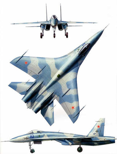

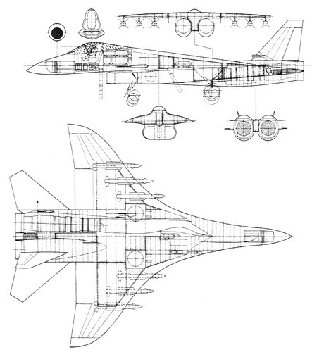

Th Soviets/Russian's thought the Rockwell F-15 was superior to the Mcdonell Douglas F-15, and I read somewhere in interview that the Sukhoi chief designer felt he could build a better plane than the MCd/Douglas F-15, But not the Rockwell F-15.
The early T-10 (Su-27 prototype) even had the gothic wing like the Rockwell F-15.
The Mig-29 and Su-27 seem to borrow from the Rockwell design, maybe the Soviets were fed some of the data? If not, was an influence at the very least.
