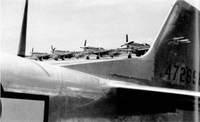

By late WW 2 most US single seat fighters had an APS-13 tail warning radar set fitted.
Another common sensor, albeit passive, was the gyro gunsights fitted to most US aircraft late war.

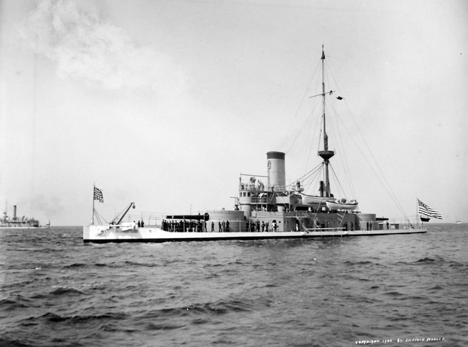

The US Navy in the late 1800's did something like that with several Civil War era monitors. They "reconstructed" / "repaired" them because Congress wouldn't fund new ships. What happened in reality was these ships were entirely new construction by the time they rejoined the fleet. These were ships like the Amphitrite and Puritan and the "repairs" took more than a decade to complete.

Puritan as originally designed and started:
Puritan (BM-1) as completed after the "repair."
