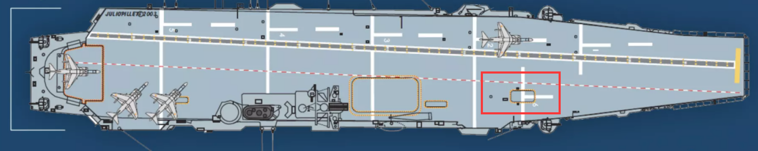

What's this on Spanish aircraft carrier Príncipe de Asturias?
Is it an elevator or something?
I don't think so. The two narrow rectangles are weapon elevators (sized for torpedoes, most likely)
You would not put a helicopter spot on top of an elevator, and detailed photos show that this is a dashed line, when an elevator should have a solid one. Maybe a VERTREP target?
I think this is the answer: that's the larger weapons elevator which can lift 4.7 tons loads.
