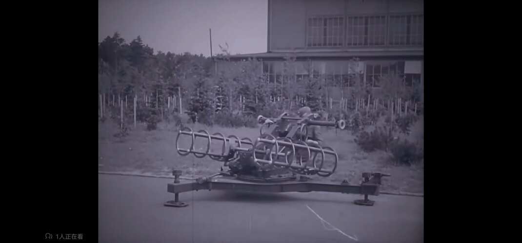

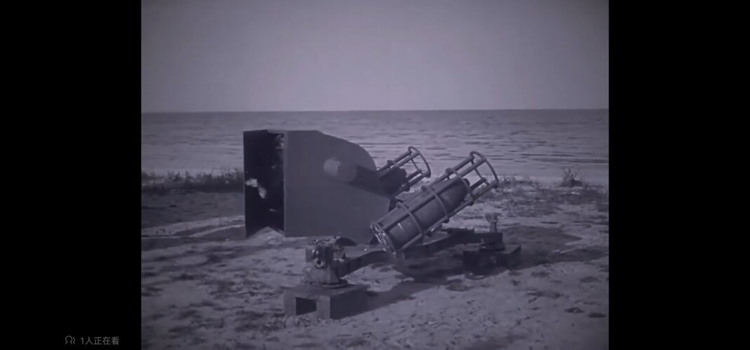

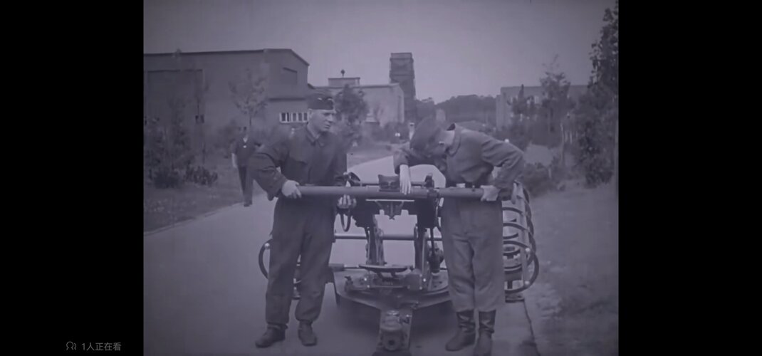

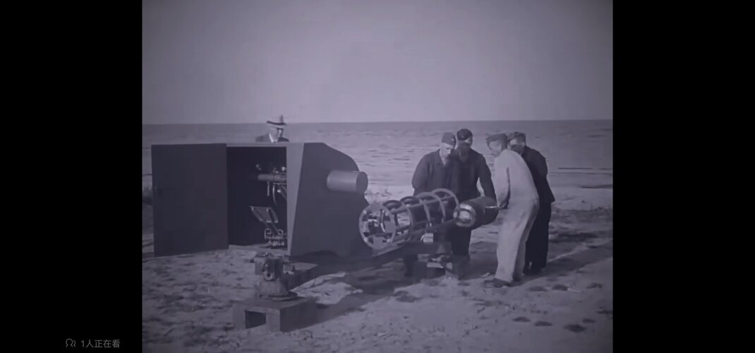

what's this anti-aircraft rocket launcher?

looks like a mixture of flak tripod and w.Gr.28 launcher

There has been no positive ID since the clip surfaced 15 years ago or so (Ordway identifies a photo the rocket as the Maikaefer in his book, but he is not too reliable) - but it clearly looks like the Stoelzel launcher, just with two rockets instead of four.

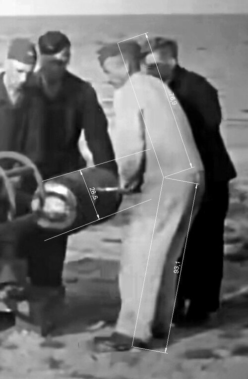

If we assume, the guy in the bright suit is 170 cm tall, the rocket calibre is around 28-29 cm. What again perfectly fits what we know of the Stoelzel launcher.

This is a heavy, short range antiaircraft rocket with blast effect, what is clearly visible during test firings shown in the film from which the stills come from. Its calibre is around 28-30 cm and the launcher, manned by one layer, is equipped with an optical rangefinder.
There was such a weapon built an tested in Peenemuende in 1943.
