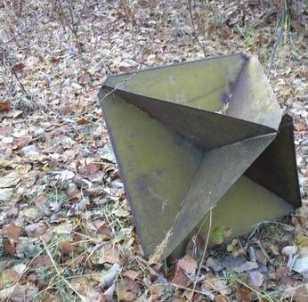

It would be MUCH easier to simply set up a fixed reflector device on a pole with a metal surface shaped (round?) to scatter the signal. Meanwhile, the incoming missile must not be hit by side lobes.

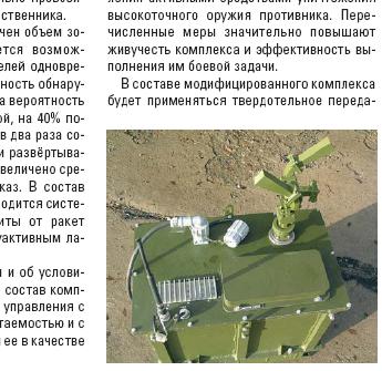

some such emitters from Russia and the US:
http://defense-and-freedom.blogspot.de/2009/03/anti-arm-decoy-emitters.html

I meant this kind of reflectors
Here's a semi-functional (German) website about air defence survivability:
http://peters-ada.de/taktik_i.htm
also from there is this link:
http://www.ncsist.org.tw/eng/csistdup/products/product.aspx?product_Id=260&catalog=10
KRT 3 decoy emitter
this type supposedly since 2002
