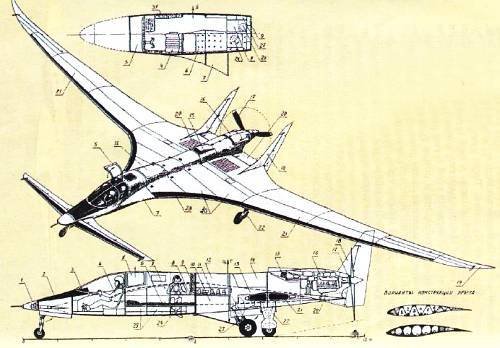

here is a strange aircraft project,I don't know its country,and if we discuss it
before or not,who can help ?.
Skyblazer said:
As the titles imply, a (beautiful) project by Anatoliy Kuzmin...
Very good Skyblazer,but that mean it is a hypothetical design,right ?.
With that size of the motor you are looking at something like 300-350hp...not enough for something of this size.
This thing would be a dog of an airplane with poor climb, poor fuel economy, and low ceiling...350hp is good for something under 5,000lbs..we have a 350hp turbocharged FADEC motor on a ~4,000lb gross bird right now and it is just about as low as you can go and have a good plane. Our aircraft is significantly smaller than this in length & span (still seats 4)...maybe it is not a flat 6 but a v6? Those put out more like 600hp which is ok....personally I would guess it would need more like 1,000hp at least...
So what could this bird's purpose be? Why just 1 far too small motor? Just seems too be completely unrealistic given available 6cyl piston engines. Maybe it has a very special motor related to its mystery mission?

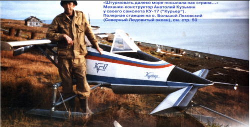

Russian mechanic and amateur aeroplane designer Anatoly Kuzmin also designed the Ku-17 "Courier" while working at Polar station O.Bolshoi Lyakhovsky on the edge of the Arctic Ocean area. It resembles more of an aero-sleigh than an aircraft.

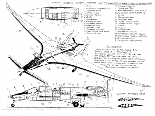

In Kryl'ya Rodiny Oct/Nov 2005 the picture below was printed along with his ideas for a multi-seat pusher aeroplane, the "Albatros" shown in the post above.
It is evidently intended for long-duration flights: there is a bunk and toilet for the off-duty pilot and the large delta inboard wing sections appear to be full of fuel.
The small engine, soaring airfoil and high aspect ratio suggest leisurely progress: it must rely on its low flying speed to be able to take off at all. I wouldn't be surprised if the engine can be switched off when conditions are favourable for soaring flight. Such motor-gliders are common enough, though not usually as big as this one.
There is also a work table for the off-duty pilot when awake and some kind of equipment bay aft of the crew bulkhead. So the craft is presumably intended for scientific research of some kind.
But why a work table? Maybe its just a dinner table?
Or am I being too naive and the question is all about what kind of research?
Perhaps going for a distance record? An 8 day long flight around the world?
That's a fantastic.
http://litlife.club/br/?b=206787&p=3
According to the accompanying text, this is the "Albatross", a proposed round-the-world flyer designed by Anatoly Kuzmin, a Russian amateur inventor.
Power would be provided by a single water-cooled 250 hp turbo-aspirated diesel engine driving a 2.4 m dia. pusher propeller. This configuration was chosen to minimise inherent drag and maximise fuel efficiency.
Length 10.12 m
Span 30.52 m
Height 3.1 m
Key to numbers in the drawing:
1 - radar; 2 - nosewheel bay, instrument compartment; 3 - instrument panel; 4 - pilot's seat; 5 - cockpit light; 6 - bed; 7 - refrigerator; 8 - navigation table; 9 - fuel control panel; 10 - No.1 tank; 11 - pump compartment; 12 - emergency NZ, life raft; 13 - main undercarriage bay; 14 - No.2 tank; 15 - oil cooler; 16 - turbodiesel engine; 17 - variable pitch propeller; 18 - tail fin; 19 - aileron; 20 - auxiliary flap; 21 - wing tanks; 22 - outrigger landing gear; 23 - main landing gear: 24 - toilet; 25 - storage; 26 - electric cooker; 27 - navigation instruments; 28 - anti-icing system; 29 - water coolant radiator; 30 - center wing tanks; 31 - oxygen equipment.
[With acknowledgements to Google Translate]

24 kg/hp? Is that right? Is so, that's going to need mighty efficient airfoils and possibly a tow plane to get off the ground!
