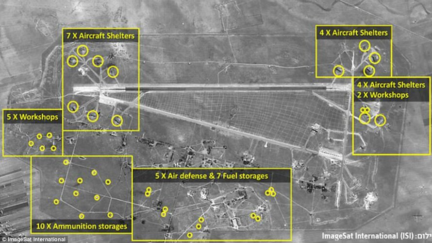

Air bases are fixed targets that literally can't be camouflage, and any damage to the runway will stop the air operation until that damage is fixed. You don't even need to fully destroy the air base, a few rocket/artillery here and there will stop enemy from take off for quite a while. On the other hand, SAM don't need a lot of space to operate. There is no "runway" that they need to operate from. In fact, you can't even stop SAM operation with cruise missile.

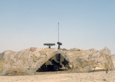

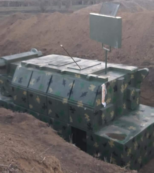

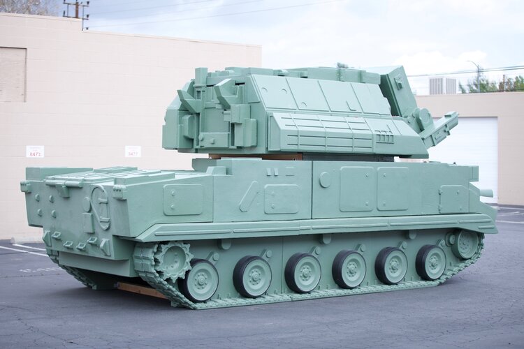

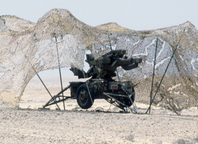

Easier to spot compared to what exactly? aircraft?
A properly camouflaged SAM is nearly impossible to spot by visual mean. Ground clutter make it much harder to detect ground target both by radar, visual and infrared sensor. Additionally, any ground based SAM can easily be cover by leaf and camo net which can erase their Infrared and visual characteristic. The same can't be applied on aircraft.
Glider bomb will require aircraft to fly at high altitude, which put them in the line of side of ground radar and ground infrared sensor. Given that aircraft are much easier to detect by these sensor. It is likely that they got shootdown before they can find anything
Damage to the runway will stop air operations on that runway. Most airbases have multiple. Further, missile damage is, as I said, easy to fix: a matter of hours if you know what you're doing. Then multiply that effort by the number of airbases in the operational area. The missile strike requirements balloon in a hurry. To give you an actual example, in 2017 the USN launched 59 Tomahawk missiles at a Syrian air base. Despite 44 hits, the airbase was back in operation the next day.
Also, one of the targets hit? An SA-6 SAM battery. So much for not stopping SAM operations with cruise missiles.
Prove it. Especially against satellites.

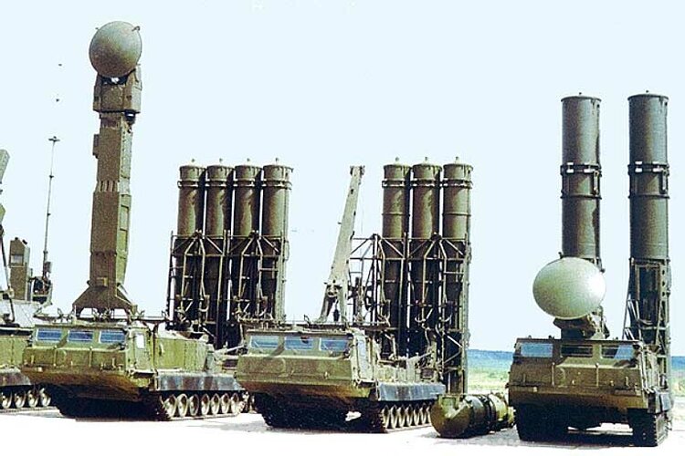

Long range SAM can easily out stick any armed aircraft. For example: 40H6E missiles can fly out to 380-400 km with average speed of Mach 4. For comparison, HARM range is 150 km, top speed of Mach 2. Kh-31PD range is 160 km and top speed is Mach 3.5. Even the future AARGM-ER range is only 300 km and with top speed of Mach 4. So generally, if any aircraft close enough to chase these SAM, they will be shootdown before they can even attempt anything. And the worst thing here is that, SAM are essentially invisible until the moment they emit and launch missile. When multiple ground radars are linked together, it certainly easy to trick fighter to get inside the NEZ before SAM are launched
Regarding that 2017 Shayrat missile strike, the 59 Tomahawk launched were not armed at the runway itself but rather the "aircraft, hardened aircraft shelters, petroleum and logistical storage, ammunition supply bunkers, defense systems, and radars. So the attack were not aimed at the runway itself but rather the aircraft itself, the fuel storage and the shelter. So there were operation from the runway the next day, not because they actually fixed the runway damage that fast, but rather that the runway were not really damaged.
About the SA-6 battery which was hit, that is only a single SAM battery against 59 cruise missiles, so of course it will likely to fail to defense the base. However, comparatively, that base also have more than 15 fighters, and they were all useless against the cruise missile attack. I would even argue that they are more useless than the SAM in cruise missile defense while cost a lot more to purchase and operate
Satellite are not the all seeing sensors that can detect anything. They are basically just optical or radio sensor at very high altitude and with wide coverage.
The fact that the NATO with overwhelming advantage both in technological level and number are still unable to clean up SAM in Kosovo and that Russia with advantage in number and technology still unable to clean up Ukraine SAM pretty much say everything you need to know about the effectiveness of satellite against well camouflage and mobile SAM. Satellite pretty much have no way of detecting something under the camo net, or distinguish between the inflatable/high fidelity decoys and actual SAM batteries

40N6 has 400 km range, SM-6 range 370-460 km, HQ-9B has 300 km range, XRSAM has 300-400 km range
Even modern fighters can't out accelerate SAM within NEZ, so they will need every bit of help to out maneuver SAM. So yes, they will have to dump their bomb when a SAM is launched at them. I have never seen any guide or any pilot say he will keep his bomb and attempt to dodge the SAM at the same time.
