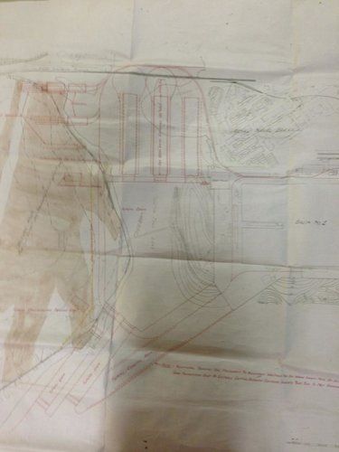

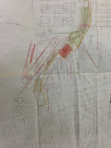

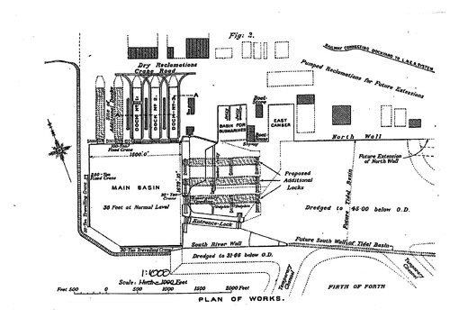

The earlier Rosyth 1926 plan is very interesting
