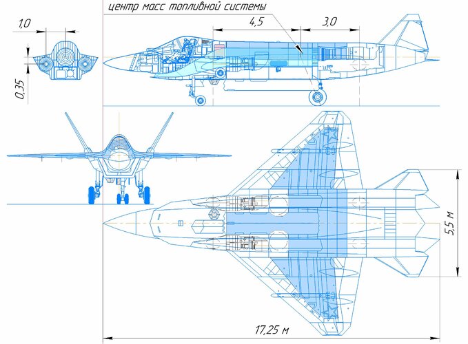

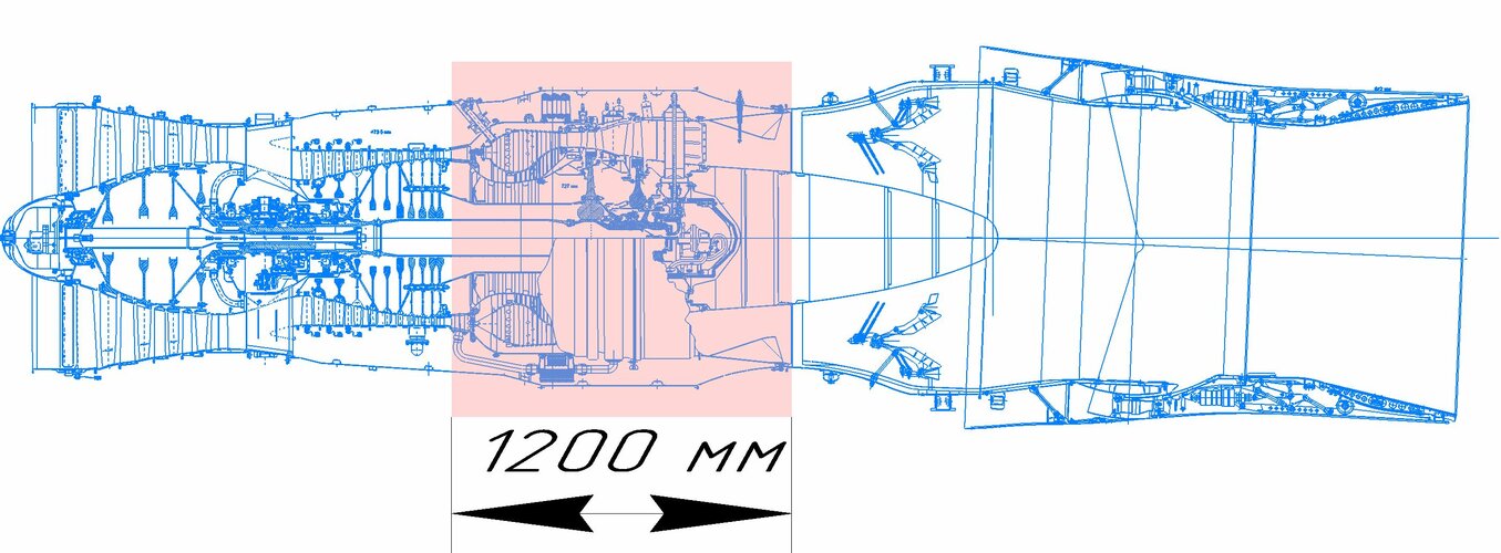

There are separate air intakes here. Instead of the RD-41, there may be afterburners. They are much lighter and cheaper than engines
Ducted rockets, you mean?
Yeah, that'd be better in terms of airframe volume needed.
It would be more correct to call this device an "extended combustion chamber". It is powered by air from the compressor of the main engine
The characteristics of such an aircraft can be viewed here, in the F column: LTS-M
English in the AK column
Ah, a burner in the bleed air vents, gotcha!
