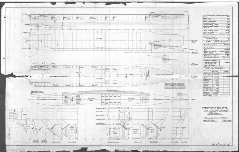

The USN wanted large carriers before the treaty intervened. In October 1918, the Bureau of Construction & Repair provided a sketch design for a carrier of 24,000 tons and 825ft long capable of 35 knots on 140,000 shp. In 1919, BuC&R proposed a carrier of 34,500 tons and 35 knots (based on the hull of one of the early battlecruiser concepts, not the 43,000 ton ships laid down). Next was a design of about 29,180 tons. See Friedman's US Carriers: An Illustrated Design History, p. 35.
If the USN is building large carriers in a treaty-less environment, some of the other powers might well follow suit.

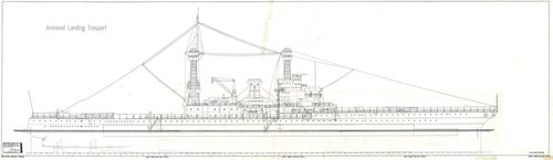

on my italian blog storialternativa.it i imagined an alternate class of ship : Armored Landing Trasport or reconverted battleship to Landing Trasport simply removing main cannons .
Converting a battleship to any sort of amphibious ship is a complete non-starter. They draw too much water for beaching like an LST and their hull shape is wrong anyway. Their hull shape also prevents converting them into a LPD/LSD. I suppose you could make them into an armored combat-loaded troop ship with landing craft but it would be completely uneconomical to do so.

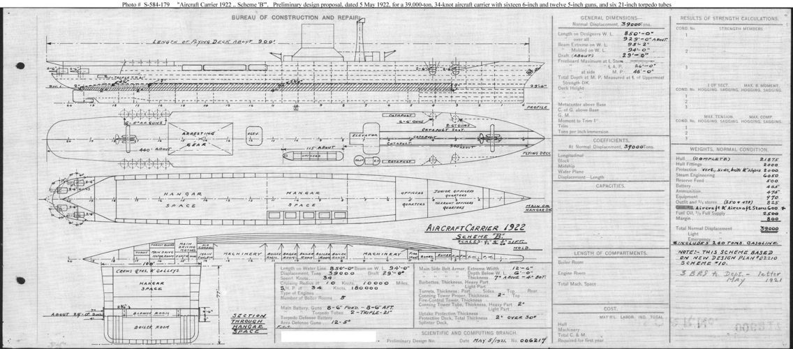

carrier development wojuld nave been stifled. With the Washington treaty the US and Japan each got two carriers maybe 15 years ahnead of their time essentially free. Grahted Japan seemed to be moving faster on carriers.
Actually no. USN already wanted large carrier, capable of operating with the battlecruiser fleet. In 1920-1922, large carriers of 35.000-39.000 tons, with the speed of 35 knots, were designed:
It is true that they had these designs, but there wasn't much chance of the USN getting money to build them. They couldn't even get money to complete the battleships and battlecruisers they had already laid down.
