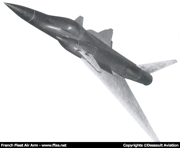

Deltafan provided a link where you can find the original single engine proposal and drawing for the Rafale before it transitioned to a twin.

Left: Single engined proto Rafale
Right: Novi Avion, 2nd version by Yugoslavia. but had significant Dassault assistance
