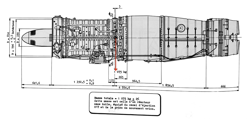

A bigger roadblock however was SNECMA M88 vs RR EJ200. And there, nobody would budge.
- A public and strategic company, SNECMA's M88 could not be ditched.
They had stuck way too long with the Atar, and while the M53 was a major improvement, it still sucked (a bit) compared to a F100 / F101 / F110.
Somewhat ironically, it was the CFM56, being derived from a F101 core, that helped SNECMA filling his knowldge gaps, improve the M53 but the real deal was the M88. There was a french equivalent to the F404/414, RB199/EJ200. Top notch middle-size turbofan. Ditch the M88, and SNECMA painfully earned place in the sun is destroyed. And since that was seen as "strategic investment" for Dassault and France... you get the point.
-Yet as a derivate of the Tornado engine, neither could the EJ200 be ditched.

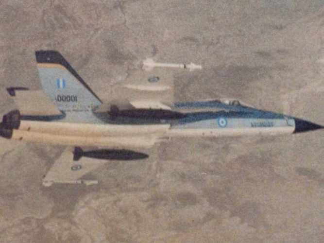

A naval fighter was never in the scope for EFA, the RN was wedded to Harriers and future V/STOL concepts and the idea a CTOL carrier might replace the Invincibles was unthinkable until the mid-90s and not on the cards. Of course in true AU world fashion we might say "what if CVA was still in service etc." but the answer would still most likely be Hornets - indeed it's possible in this scenario that the Hornet might have killed EFA in the late 70s had the RAF/RN agreed on a Hornet buy to replace all their Jaguars and F-4s as it was already a frontrunner for AST.396. Then perhaps we might have seen a Franco-German-Italian ACX.
Logically the AN (AeroNaval) had preference for either Mirage G, with their eyes on strike and fighter variants.
Or the A7 Due to the avionics.
In cost terms the A4 was the strongest case and behind that was the Jaguar. Which at least had degrees of commonalities with AdA (Armé de la Air).
But there was no money to make the alterations necessary to turn Jaguar into a viable platform for the AN.
SEM only stood a chance because Etendard was already in service and there was little barrier to integrate French avionics. Particularly for Exocet.
The A4 route with French avionics could have been a game changer. And French companies could offer a package to A4 users.
Had Mirage G been funded, this would sweep off the decks both Etendard and Crusader.....if the money was there.
Had Jaguar received the funds for proper navalisation, this too could have swept off the other types.
The wildcard is adopting the Sea Harrier, but as with the above it's all in the late 60's and early 70's.

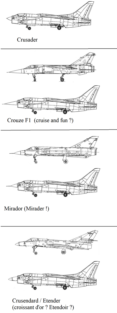

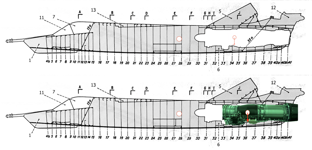

I have this crazy vision of a Super Etendard « Dash 5 » upgrade. Similar in concept to the Sea Harrier FA2.
Ordered 1990, first deliveries 1996. With scaled down RDY radar, Mica missiles, and M88 engine. Wouldn’t cost that much given the ability to leverage Mirage 2000 avionics and Rafale engine technology.

I tried mating some Dassault "noses" to Crusaders. Not exactly fitting, but lots of fun at least, including with the stupid names and puns.
Behold... the hybrids. All three Dassaults had Cyrano variants: II, IV, or Anemone / Agave. Same family of radars.

My only concern here (I've had similar ideas for various aircraft over the years) is what to do with the afterburner as the engine is very much mid mounted. Is RR Lightning's Avon style extended exhaust and nozzle petals an option on these modern and very complex turbofans?
From what I can tell, this might be a non-issue as the M88 and Atar 8K50 are very similar length wise.
The M88 is 40cm shorter, so assuming the exhaust nozzle is in the same location the M88 would be mounted slightly farther back than the Atar. That should be fine because the M88 is ~200kg lighter so you’d want to move it back anyway to keep a similar center of gravity.
The Super Etendard’s removable tailcone would have to be enlarged slightly to fit the larger diameter rear afterburner section.
From what I can tell, this might be a non-issue as the M88 and Atar 9K50 are very similar length wise.
Do you have any information on the Atar 8k50 as used by the Super Etendard? The weights might be a little different as it has a different compressor stage etc to the supersonic capable Atar 9's. But the fit does seem relatively good depending on the engine CoG. When South Africa reengined a Mirage and Cheetah with the SMR-95 variant of the RD-33 they had to mount the engine 600mm back compared to the Atar 9 even when the engine was only ~500mm shorter in overall length. Of course the longer petals on the modern engines shorten them up a little bit too so significant modification to the tail area will be required. It does seem doable however.
Here’s a comparison of the M88 vs. Atar installation, keeping the Center of Gravity roughly the same. Seems feasible IMHO.
How I did this:
The 1st drawing is the Atar 8B as fitted to the Etendard IVM. The Atar 8K50 should be similar, just ~70kg heavier and 5cm longer. This also shows the engine’s Center of Mass, which I’ve highlighted in red and added to the Etendard IV blueprint (2nd drawing). I’ve also estimated the Etendard’s center of gravity (~50cm forward of the main landing gear, 2.6m forward of the Atar’s center of mass).
Then I did the same with the M88 engine in lieu of the Atar and calculated the moments to position the M88 at exactly the right place so as to have neutral impact on the Etendard’s CoG. The result is the M88’s center of mass is ~60cm behind the Atar.
