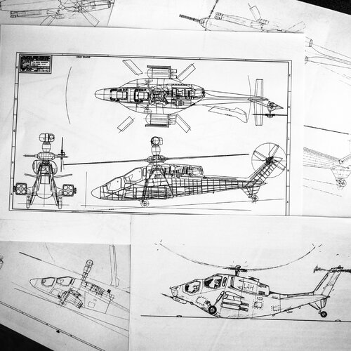

I just found this....The paper by Ron and Jerry says that we did not examine single engine options for the A129LAH....well, we did! I did most of the work and we dreamt up several variations on the theme. It was a single vs twin engine study....and having been heavily involved in the single engine P106 canard delta at Warton I wanted to see if the advantages applied to helicopters. Despite trying hard to make a case it was pretty obvious that, with the basic platform, it wasn't going to happen. But I had a lot of fun with the dead man's curve and engine failed modelling! Tom Abbott did the drawings...all I did was to nudge his elbow.

Just read the paper more thoroughly. There is an error re the A129LAH. We carried out a design exercise of single vs twin engine variants and which formed a sizeable appendix to one of the final reports (did not change the price of fish though). The paper peters out after Ron left for BAe and Jerry moved upwards and onwards from Advanced Engineering since there were some significant studies for complementary platforms to operate with the AH. And then the AH procurement competition was something else.
Paul, this will be corrected shortly. Jeremy will also be in touch.
Being a jet jock you performed a single vs twin study, had you been in helicopters you would not have even started… In any case I do not remember reading that part… age probably. I had one of the drawings in the picture framed, it’s in my house.
