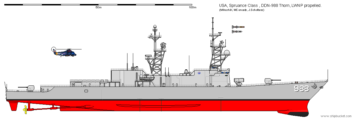

Does anyone have anything more on this Westinghouse concept?
http://www.dtic.mil/dtic/tr/fulltext/u2/b064568.pdf
Prospects of Nuclear Power for Smaller Combatants
