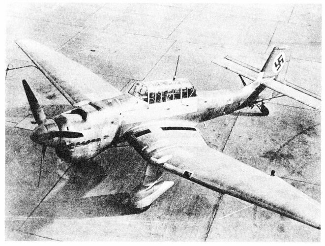

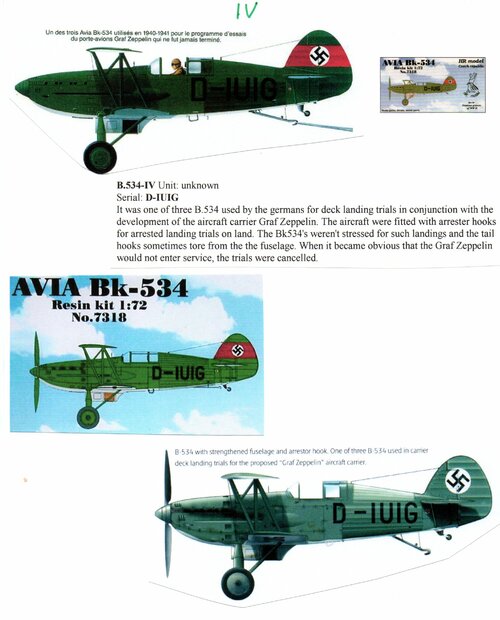

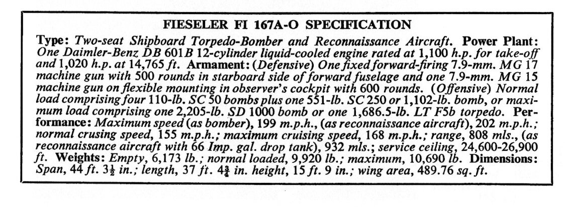

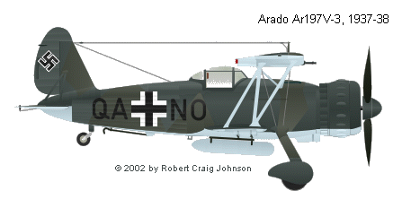

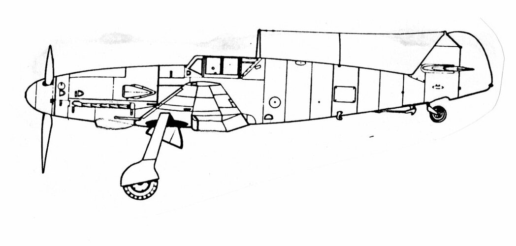

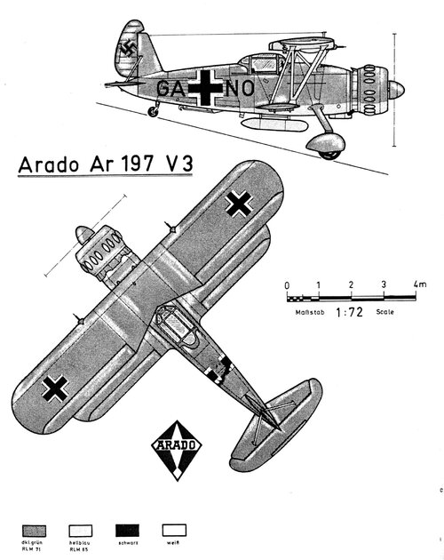

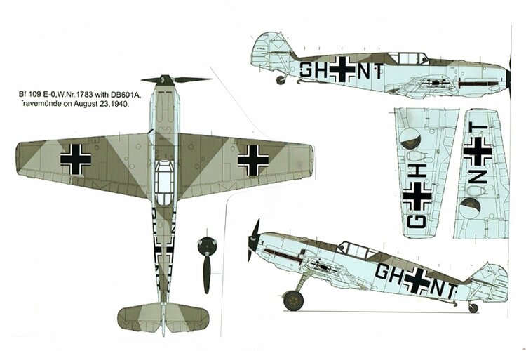

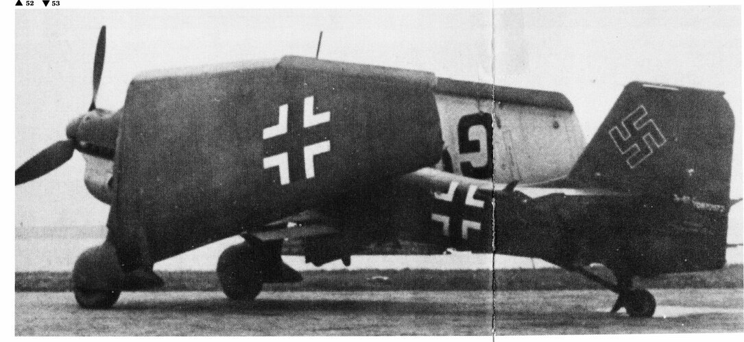

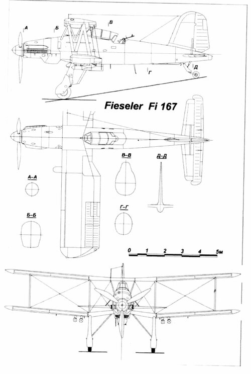

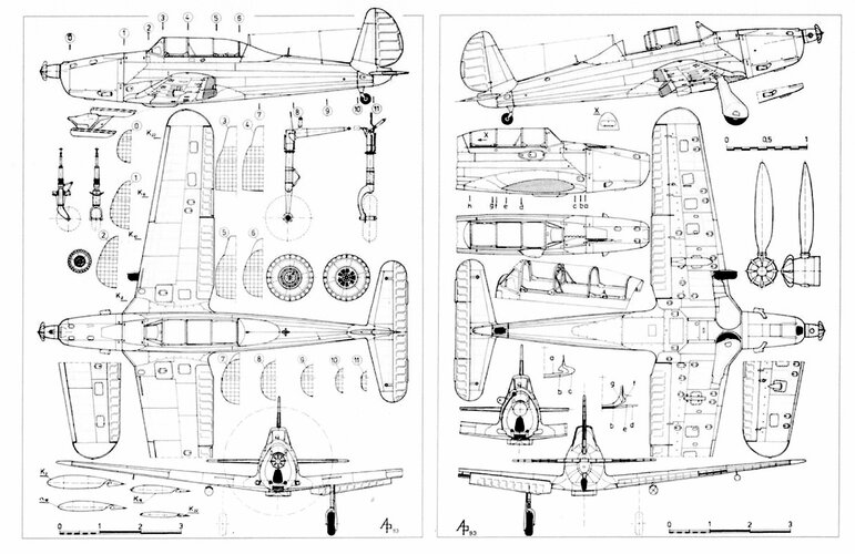

Well first thread here but a buddy of mine asked if the RLM had any specifications for carrier-based planes, as well as other plane candidates than the Bf-109T, Ju-87C, and the Fi 167.
Junkers Ju 87 C

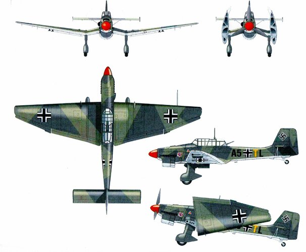

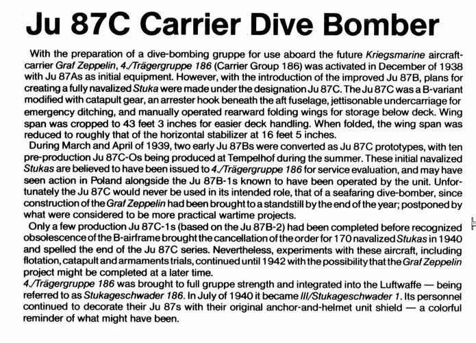

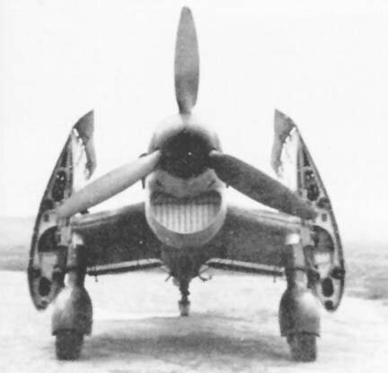

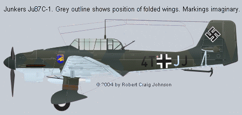

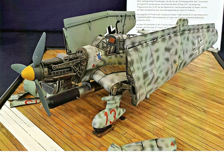

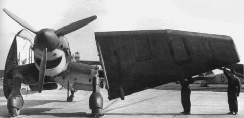

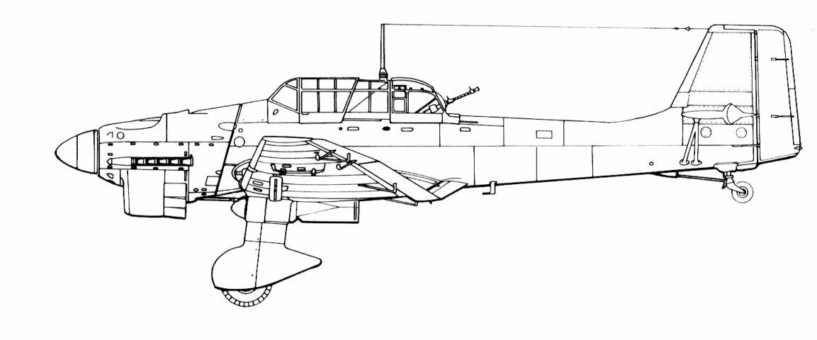

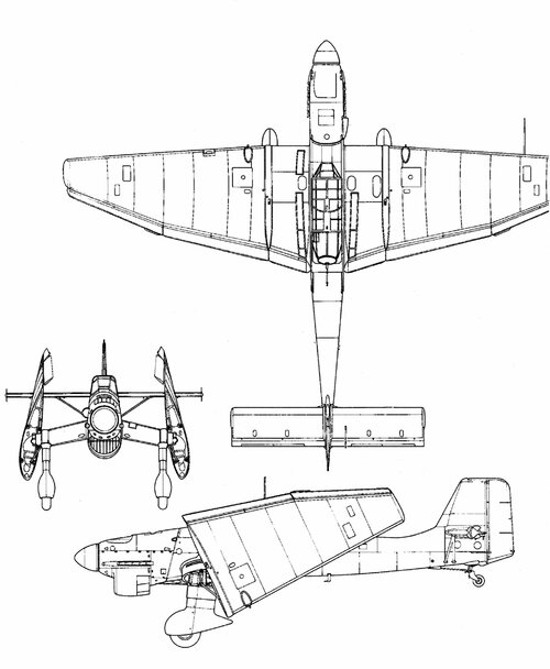

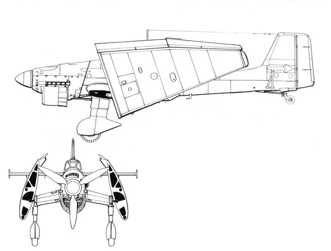

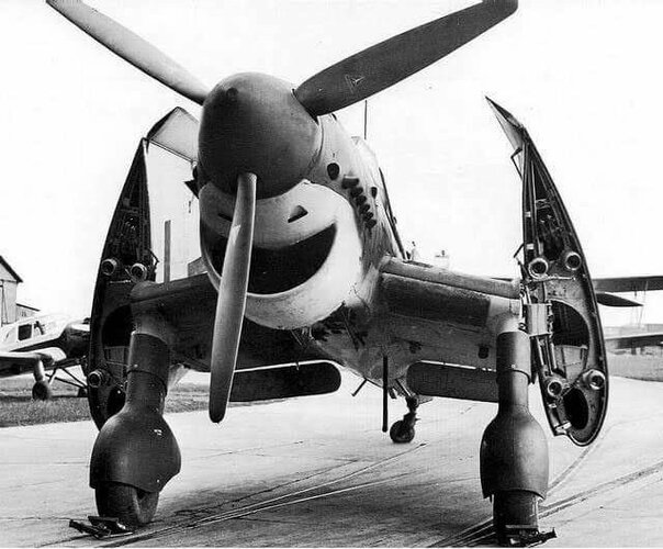

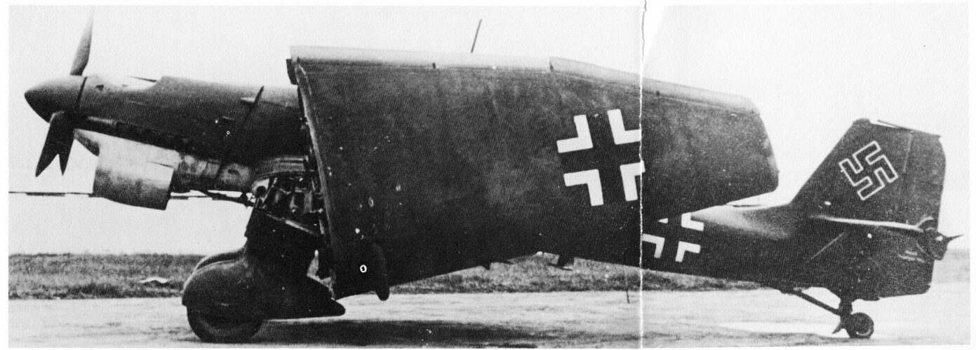

What kind of folding mechanism does the Ju-87C use Grummans STO-wing design ?

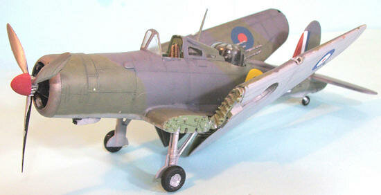

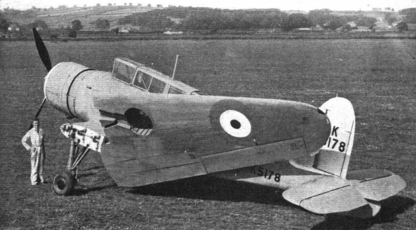

Blackburn Skua double articulation floding system

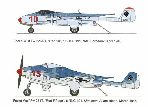

Baxter's "Tragerflotten" had the HE-100 replacing the BF-109 as the main carrier fighter and also had German versions of the Japanese "Jill" torpedo bomber.

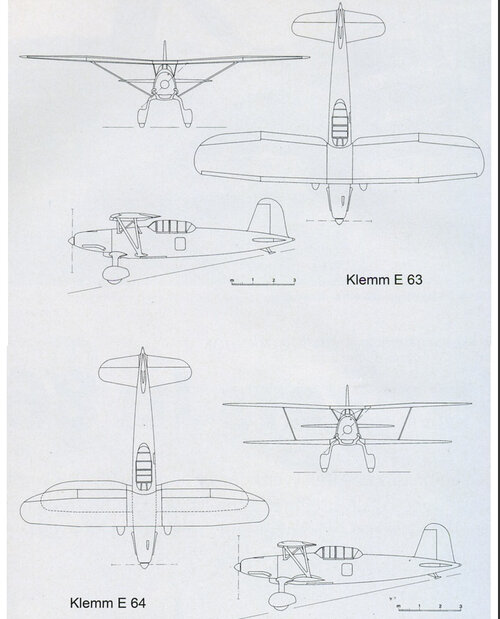

Klemm E63 and E64

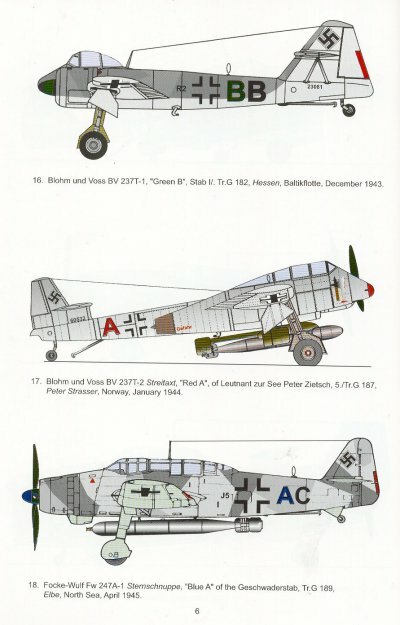

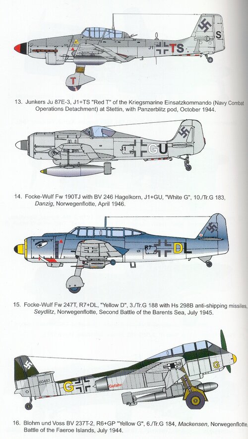

Fictional stuff properly belongs in the alternative history and speculative design sections of the forum.

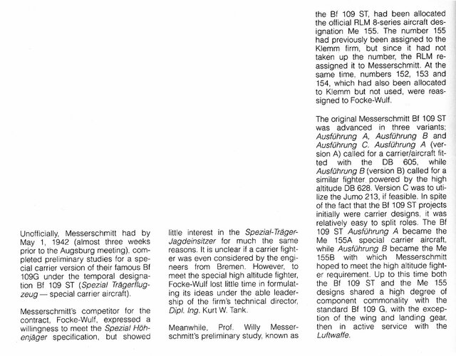

I know that Germany had an assortment of twin engine designs drafted when the Graf Zeppelin was being worked on again in 1942. Let me see if I can find some pictures.
