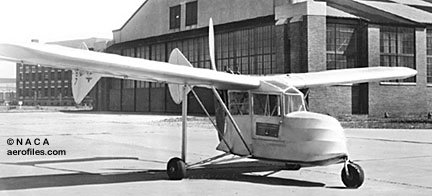

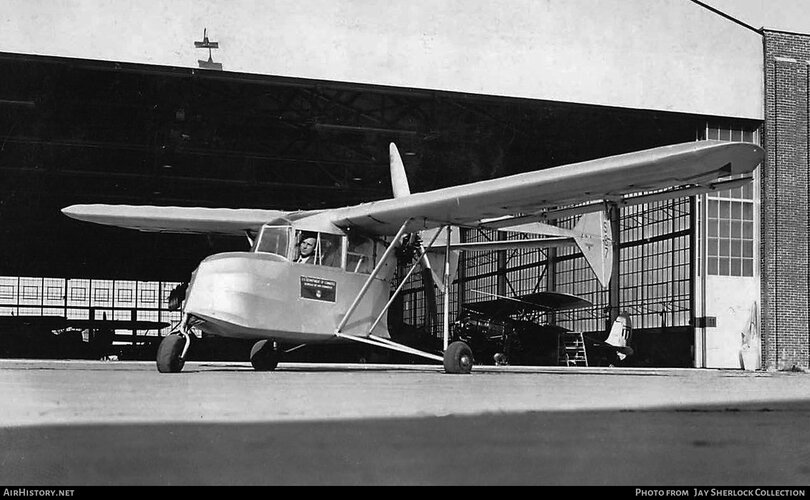

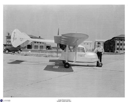

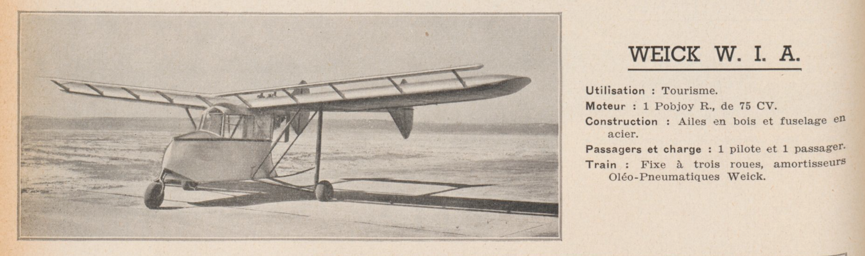

Here's the Weick W-1A (NASA Langley).

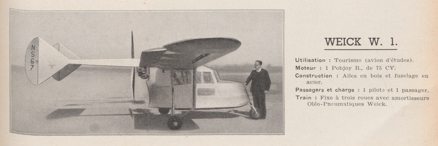

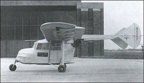

Then during the winter of 1933-34 he, along with some friends, constructed his first aircraft which embodied his criteria. The aircraft was a high wing monoplane (unique in 1934) with a pusher engine, twin booms to twin rudders, the main wheels were widely spaced at the rear and .. . "HORRORS!" ... there was a nose wheel.
Now, this really shook up the Civil Aeronautics personnel. The plane was appropriately called W-1. The plane was built following a series of tests with gliding models -built in his basement in slightly over a year's time -the cost approximately $2,000.00. This included a geared drive Pobjoy engine. Built of wood and steel tubing it is interesting to note some of the design figures. The plane had a 30 foot span, weighed 1,150 pounds, wing area was 161 square feet but it only cruised at 80 mph. But it did accomplish its purpose. Its stalling speed was 35 mph, take-off run was 120 feet and landing run was 100 feet.
About this time the Bureau of Air Commerce, under Mr. Vidal, became interested in private flying and started a research program to produce a $700 light plane that would be safe for the average man to fly. The man they placed at the head of this project was Mr. John H. Geisse.

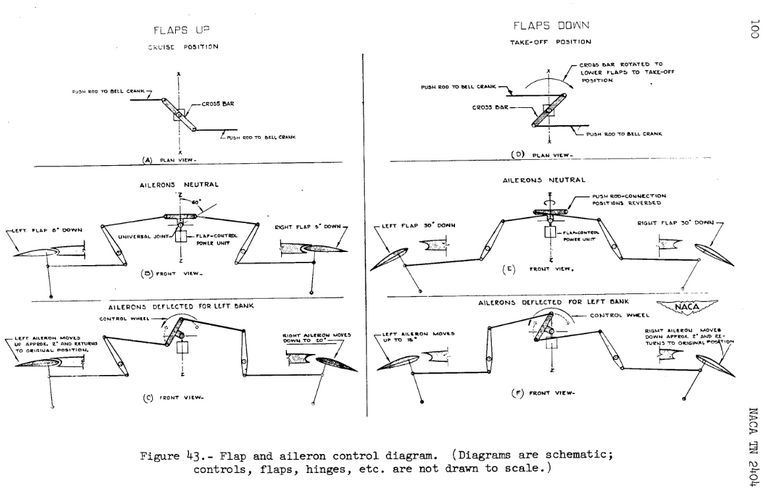

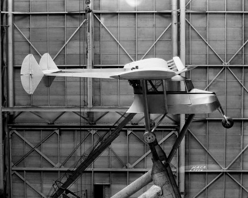

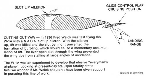

His first step was to contact the NACA. There he met aircraft which met or exceeded their proposed specifications. The Bureau arranged to purchase the plane for tests for $5,000.00. This accomplished, they immediately ran into a typical bureaucratic reaction of aversion at the purchase of a "backyard" aircraft. Therefore, they had Fairchild construct a copy so they could test a "professional" product. This plane was called W-1-A. Similar in all respects except the plane was equipped with flaps instead of the fixed slots on the original. Again, typically, they were so sure something had to be wrong with a nose gear that they ended up destroying the aircraft trying to produce "shimmie" in the nose wheel. All this in the face of the fact that no "shimmie" problem had developed in the original design.
