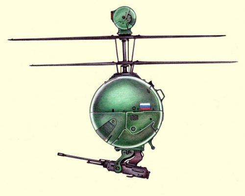

Just consider the force feedback on such a tiny UAV during the fire and the most important thing - the times, when you spray your enemy a bit with a bunch of unguided bullets is definitely gone. When we are talking about the UAVs, I think, that such a era didnt have time even to start.

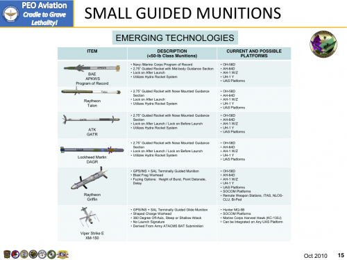

How about a laser guided APKWS? IIRC a Vigilante helicopter UAV has already demonstrated 2.75" rocket firing capability. Collateral damage is less than a Hellfire, and the Israelis have used those to take out individual high value human targets. Guidance is also easier than trying to stabilize a sight and gun mount and achieve the required precision.

There are a number of other options.

Those are all excellent options as well, but bullets or cannon shells, even smart shells that burst at a calculated distance, are still a lot cheaper and less likely to cause unwanted collateral damage.
A long-endurance COIN/CAS UCAV armed, for example, with two 19-round pods of guided rockets,' twelve Griffins, four Hellfires, and a stabilized and and precise turret-mounted gun, say a .50 cal or a 20-25mm gun, would have the deep magazines and the scaleable range of response to deal with anything from a lone sniper to a main battle tank.
Photo of a Thales UK Lightweight Multirole Missile installed on a Schiebel S-100 Camcopter UAV on Flightglobal siteweb (bottom of the page):
http://www.flightglobal.com/articles/2011/04/05/355186/uk-orders-thales-lightweight-multi-role-missiles-for-lynx.html
Yes, the need to arm UAVs and provide manned vehicles with scaleable response is spawning lots of smaller, lighter guided weapons, but, so far, few suitable turret-mounted guns.
