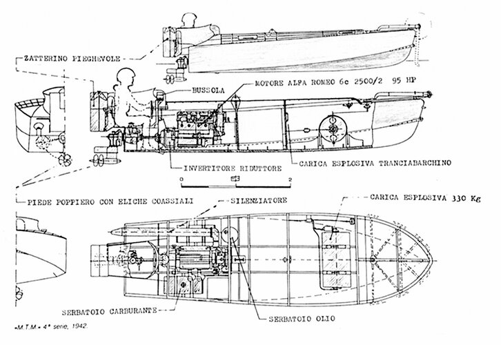

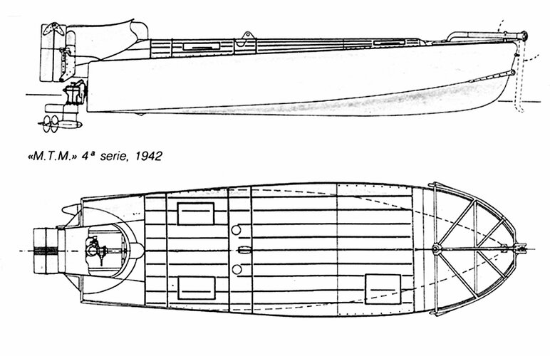

The Italians EMBs sank the heavy cruiser York at anchor at Crete in the first attack they ever made. The German Linse likely sank a destroyer and a trawler off Normandy though this took place in conjunction with an attack by conventional motor torpedo boats so its hard to confirm. Shinyo were specifically the Japanese naval EMBs, the Army had its own Maru-in. In all cases, the first attack or few attacks were generally successful, and aggressive allied air and naval patrols then inflicted heavy losses on all further attempts or thwarted them completely. In the case of Italy, who by far had the least sucidal design with an actual raft for the pilot to use, the second attack attempt, against Malta, was totally wiped out by shore batteries and strafing fighters then sank the launch ship. The British though were impressed enough to design a similar vessel built in small numbers. German and losses were made worse by several nasty accidental explosions with the craft tightly packed in caves or canal locks preparing for launch.
The Boom Patrol Boat, so called because it was used by the Royal Marine Boom Patrol Detachment, which was the cover identity for Blondie Hasler's maritime special forces unit (c.f. Operation Frankton/the Cockleshell Heroes). There's a good background on the development and planned utilisation in A. Cecil Hampshire's 'The Secret Navies', including pictures and a small drawing. The BPB was a Vosper design that was to be 18' x 5' with a 2' draught, weigh 3,500lbs and carry a 500lb charge with impact, hydrostatic and time fuses selectable by the operator. Lagonda engines were specified, but so was compatibility with the Ford Mercury (and the drawing shows a Grey Fireball). Speed was to be 30kts. There were two cockpits, one at the midpoint designed to cushion the operator on landing and a second at the rear using the same detachable paddleboard/backboard the Italian boats used.
