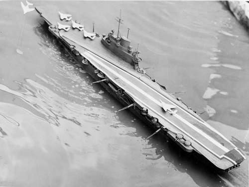

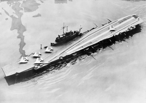

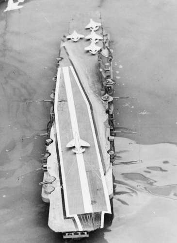

Nope, they were generic models actually made in 1945 for illustrative purposes using an Illustrious-class model, probably the same one illustrated above before it was given the 'sticker'(?) to show the angled deck.
They were made by a member of the NAD at RAE Farnborough, Geoffrey Cooper who wrote Farnborough and the Fleet Air Arm, Midland Publishing, 2008.
In the book he mentions the aircraft models with a photo of the Illustrious model taken in 1945 with the normal axial deck. He made up a generic jet fighter shape which was a good guess to the later Supermarine 508. The purpose was probably to look at deck handling arrangements for jet-powered aircraft. He even pondered if his work may of accidentally inspired the later angled deck; he recounts how a plywood copy of the flight deck layout he made was left sitting on top of the model ship at a skewed angle, thereby looking like what would later become angled-carrier deck.
I presume in 1952 the model was given a lick of paint or some from of adhesive sticker to represent the lines of the angled deck.
