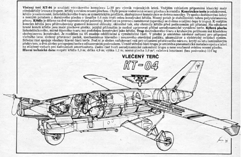

Until I will speak about its list,from L+K 19/1978,
the towed target,KT-04.

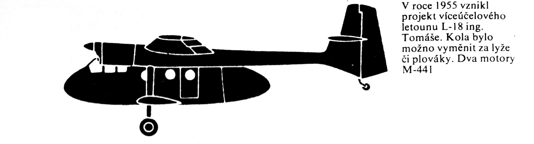

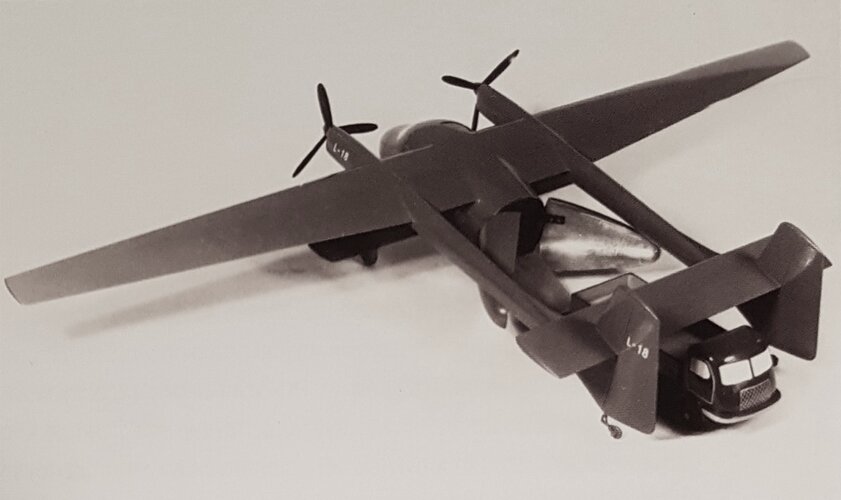

L-18 multipurpose aircraft (1955), if built in series, then it would be manufactured by Letov.

KT-04 With the arrival of the L-39 aircraft, it was necessary to develop a lighter target, which could be towed behind the L-39V aircraft, and thus again formed an all-metal target KT-04. (It was produced in series by Letecké opravny Trenčín).

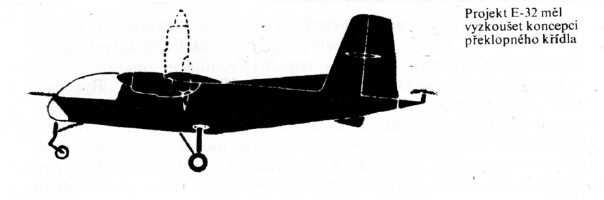

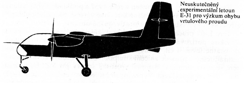

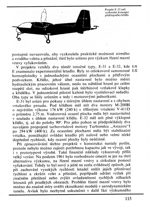

E-31, E-32, E-33 In 1959, the VZLÚ design group, led by engineer Matějček (who was also the designer of Czechoslovak gliders of the time), was commissioned to design three experimental aircraft to test the practical possibilities of V / STOL.

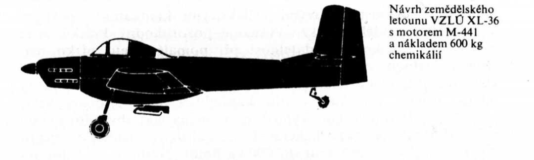

XL-36, study of an agricultural aircraft, M-441 engine, hopper capacity 600 kg.
