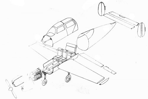

The powerplant is intriguing. Are we looking at a twinned horizontally-opposed 6-cylinder or some kind of air-cooled X-12?
Could be a six-cylinder vertically-opposed engine...

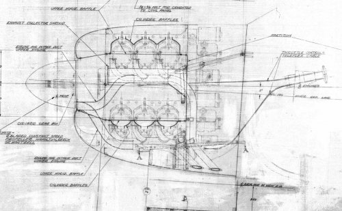

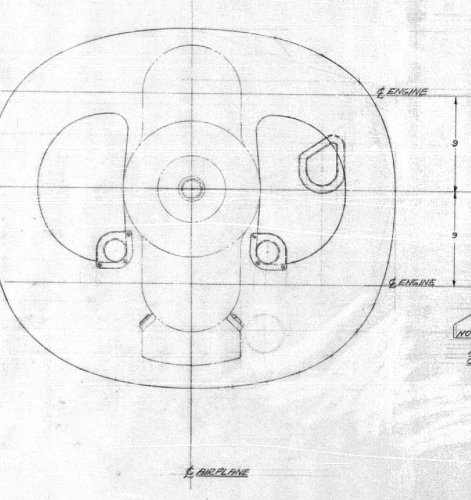

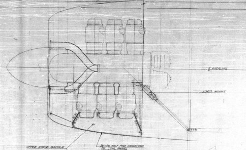

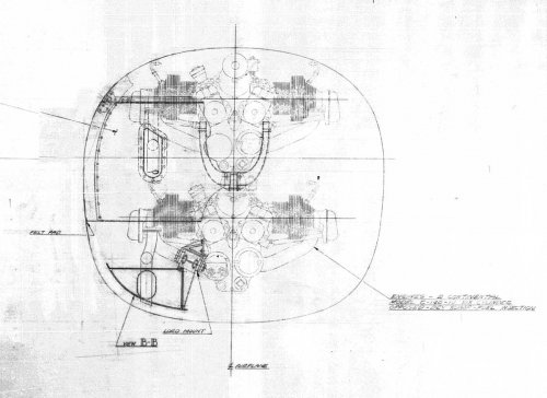

Your questions about the engine sent me back into the raw scans from my visits to VAHF.
In doing so, I found a drawing of the engine that I am trying to clean up to share.
I can read that the power plant consists of 2 Continental Model C-140-IJ six cylinder
opposed, dry sump, fuel injected engines.
As soon as I can get the scan into decent shape I will post.
As promised, here are the clips from drawing CVS-14209 Sheet 1 V-348 Power Plant Installation from VAHF microfilm.

After attempting a very crude reassembly of the parts, there are obvious inconsistencies in sizes and shapes, especially the nose (engine cowling and propeller) which absolutely can't fit the rest properly. It might have to be enlarged, but even then, it would become too wide for the fuselage, so without other depictions there's a whole lot left to speculation...
