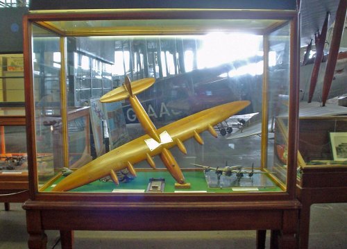

The bomber design is not believed to have been developed beyond construction of a large wooden wind tunnel model which survives today at Brooklands Museum but the earthquake bomb idea was continued, initially as the smaller 12,000 lb (5,400 kg) Tallboy bomb, and then the larger 22,000 lb (10,000 kg) Grand Slam bomb, the carrying aircraft being a modified Avro Lancaster, whose performance improved during the war to the point where it could manage such a load.

Plus From Brooklands Museum - the wind tunnel test model:
