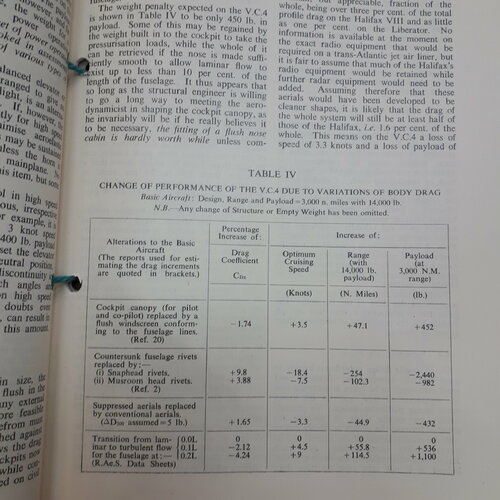

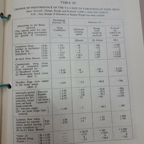

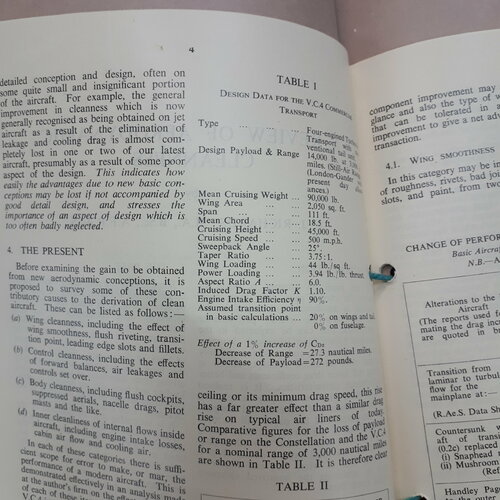

I have come across some information on the proposed VC.4 three-engined transatlantic airliner project of 1949.
Information on the VC.4 was used to demonstrate aerodynamic drag issues in a Royal Aeronautical Society lecture by E. J. Edwards on 24 November 1949 entitled A Review of Aerodynamic Cleanness.

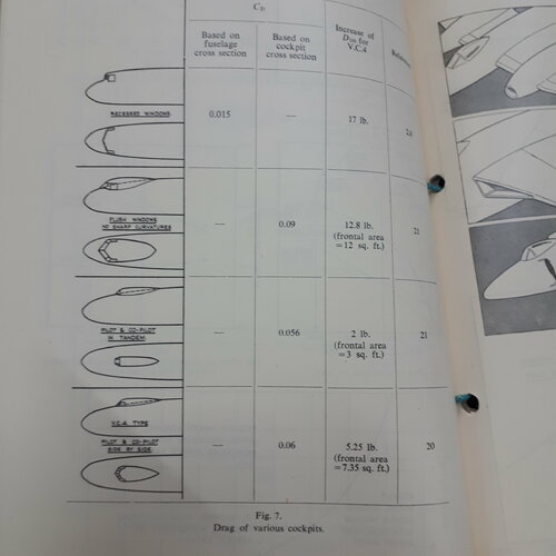

The diagram of the cockpit layouts is interesting, the bottom one is labelled "VC.4 Type" is very similar to that of the Valiant, which by then had been ordered in prototype form.
