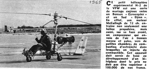

The VFW H.1 was a single seat conventional helicopter offered to the army , but refused because not innovative enough .

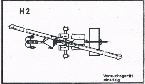

I don't have illustration for the H.1 , only the H.2 ...

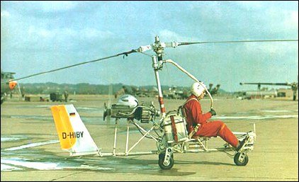

Helicopter : it had combustion chambers at the rotor's tip .
Combustion chambers... Hmmm... Was it another ramjet-tip helicopter, as Hiller's Hornet (HOE/H32)?
A.
The McCulloch engine drives the two blades propeller AND a compressor which supplies air to the rotor's tip combustion chamber , where it is mixed with fuel .
It is the very same principle as the late war WNF-Doblhoff 342
