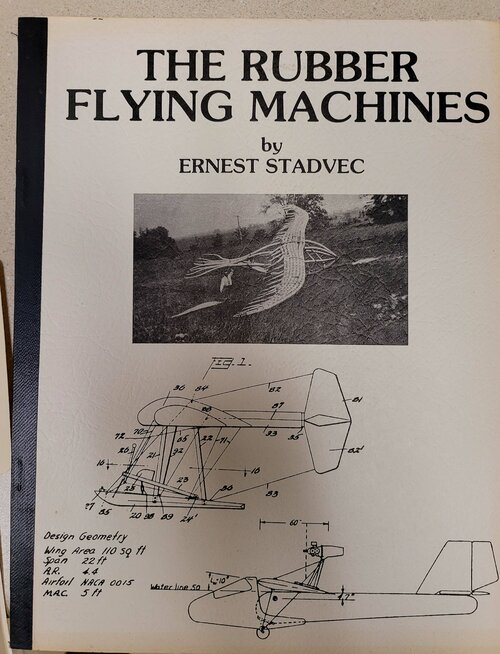

GooYear , made something similar to a rubber airplane by pumping. But the Soviet Union also had an airplane in 1930 whose wings changed length.
I`m honestly surprised that the inflatoplane concept has not been seriously re-investigated both for drone and manned ultralight applications
One can easily imagine its potential with the new materials and technologies that have been developed since the 50s.
