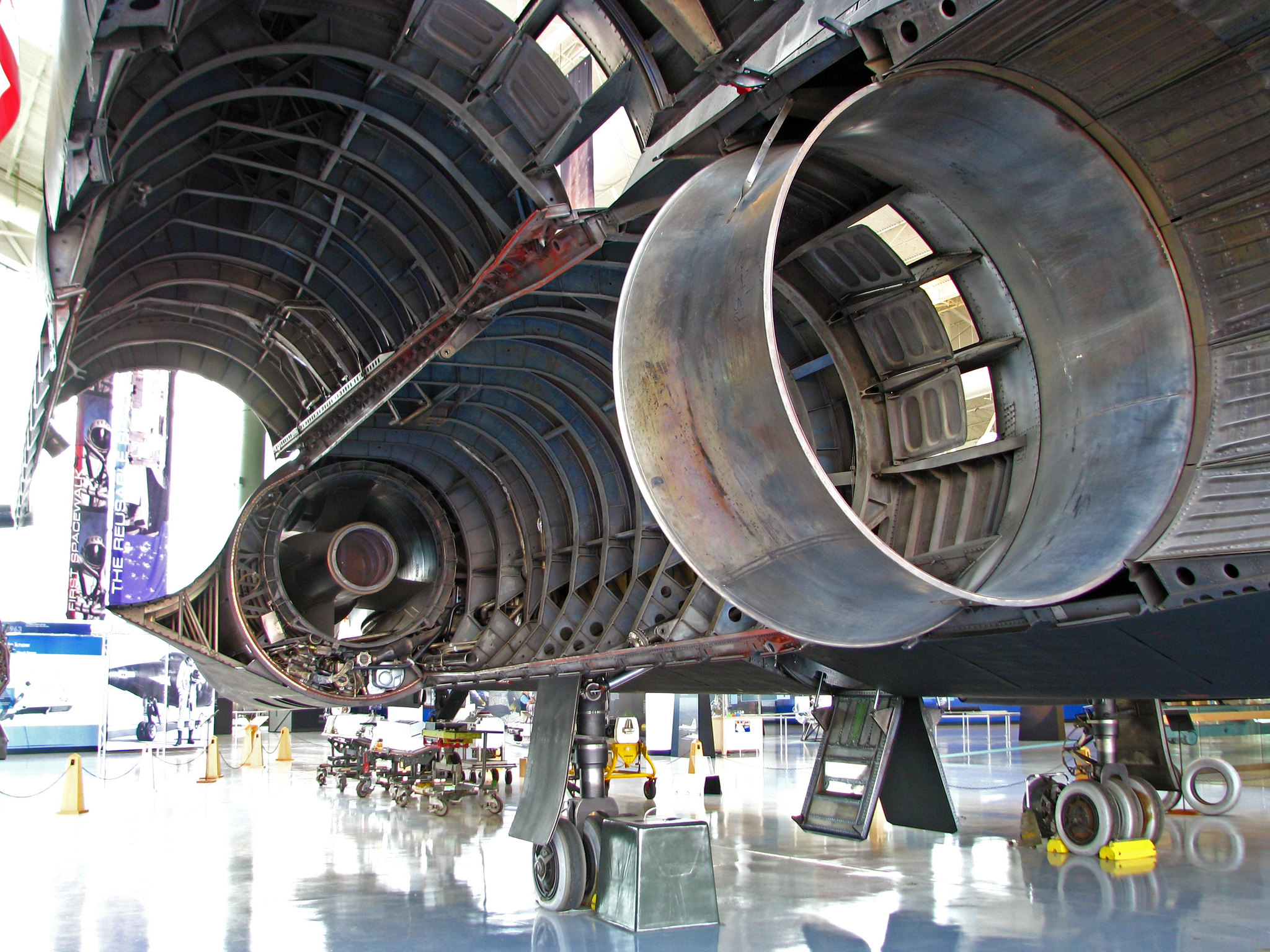

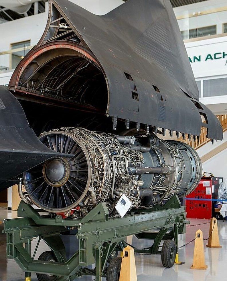

A-12, SR-71 ;)
That structure, the nacelle rings and all including the wing, was already quite robust for a variety of reasons.
Compare that abundance of structure with the subsonic Citation's nacelle below which doesn't take those loads. Also features, an easily removable cowling for engine maintenance access, not possible with integrated structures in the Blackbird family.
A whole bunch of premium reasons (weight, cost, maintenance access/cost, etc) to avoid that in your VTOL commercial bizjet.
