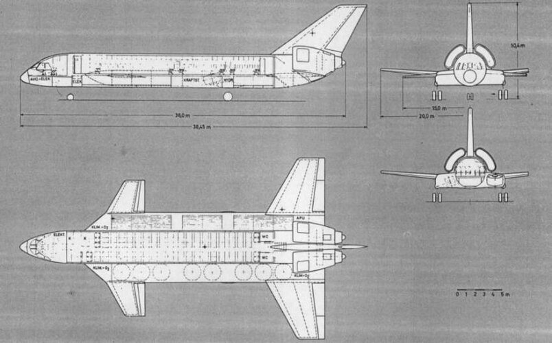

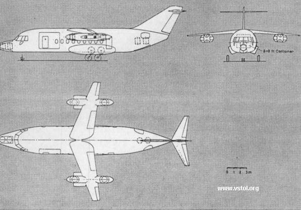

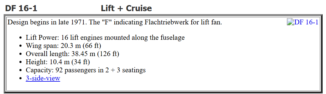

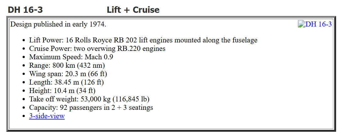

** A series for transport

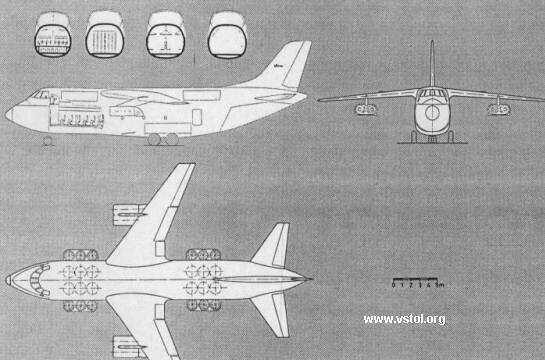

HFG 5,HER 15,DH 16-3,DH 16-4,DF-16 & TH 16 all were a VTOL transport
projects
