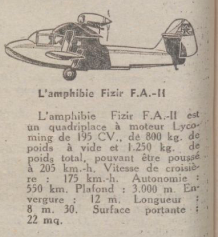

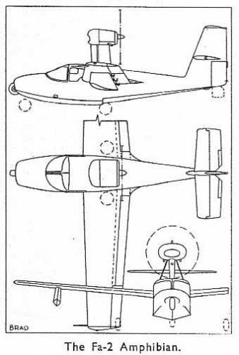

Fizir Fa-2 was the last project of the aircraft designer Rudolf Fizir and the further development of the prewar Fa-1 design. It was designed to meet the requirements of the Horvat Aviation Association for a small four man amphibian suitable for passenger transport along Yugoslav coast and islands. The plane was made of wood in order to allow for limited production in small facilities. The prototype was nearing completion in 1955 but was never finished and Fizir died in 1960. It would have used one Lycoming O-435 195hp engine.
Span: 12m
Length: 8,34m
Empty weight: 800 kg
Loaded weight: 1250 kg
Max speed: 205 km/h
Cruising speed: 175 km/h
Landing speed: 90 km/h
Ceiling: 3000m
Range: 550 km

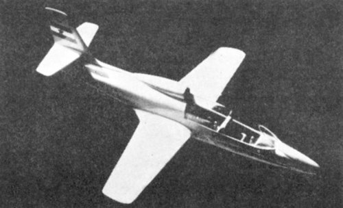

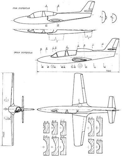

KBL-12 would have been the first jet aircraft designed by a Slovenian, engineer Marjan Slanovec. It would have been built in LIBIS factory (Letalski Institut "Branko Ivanus" Slovenia - Aircraft institute Branko Ivanuš). This 1954 project for an all metal aerobatic plane was the only project from the kbl series that wasn't built. Others were gliders and sport aircraft. A real shame.
Span: 6,5m
Length: 7,32m
Height: 2,65m
Empty weight: 355 kg
Fully loaded: 700 kg
Max speed: 510 km/h
Cruising speed: 450 km/h
Range (at 3000m): 450 km
Range (at 9000m): 900 km
Engine: Turbomeca Palas

Just a question: The upper side view and split top view shows an
alternative or earlier layout ?

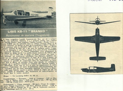

He is here from an old " aviation magazine"

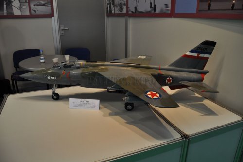

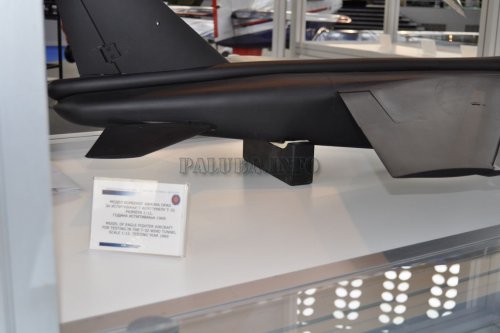

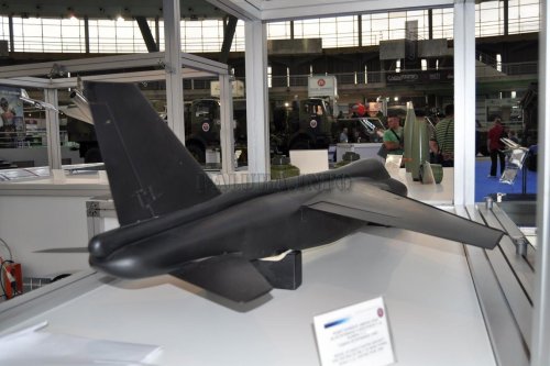

Photographs from paluba.info forum, taken at Partner 2013 fair, wing tunnel and scale models of Soko J-22 Orao.

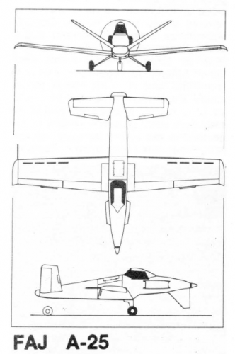

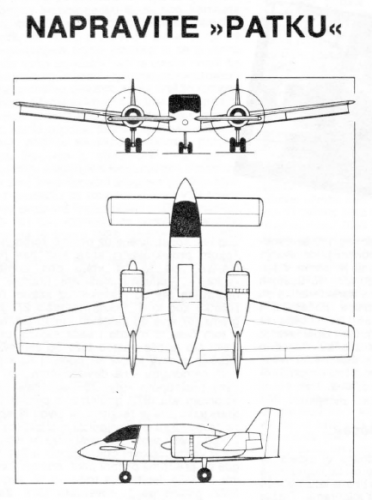

Also from Aetosvet 06-07,
here is the FAJ A-25 and a small info about FAJ family,and a canard aircraft called Napravite Patku,and
a light aircraft called Najbolje Tricikl.
FAJ stands for Fabrika aviona i jedrilica - Aircraft and Glider Factory, Vršac (JAT pilot academy is situated there).
Napravite patku means build a duck.
Najbolje tricikl does not mean anything; najbolji tricikl means the best tricycle, they probably meant the best project with the tricycle landing gear arrangement. If you could post the whole page, I might be able to identify the models.

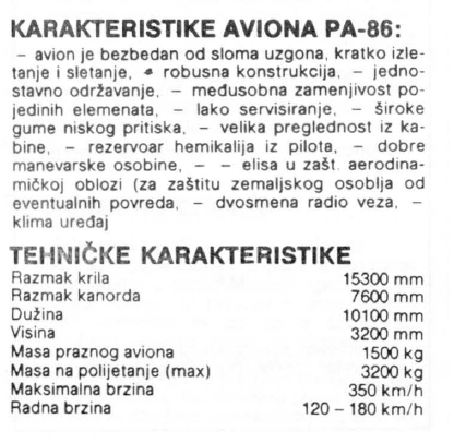

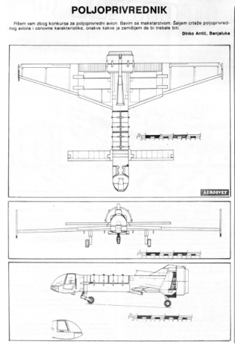

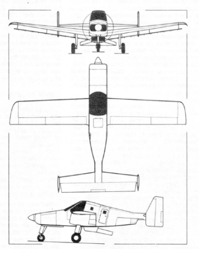

From Aerosvet 09,
here is an aircraft project,but I don't know what was its real name ?,they wrote
PA-86 ?.
np hesham, just ask :)
This is not a real project, just a reader (who is also a model maker) submitting his drawing of how the ideal agricultural plane should look like and some basic characteristics.
Poljoprivrednik means farmer, and the 86 is probably the year of publication, similar to Moma 86.

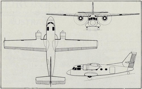

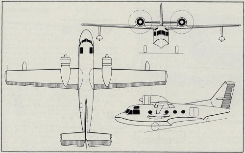

Nikolic NI.17
Nikolic NI.18 (both from Janes 1964/65).
Great find Maveric,
and those two projects was belonged to UTVA,and I mentioned them before,here;
http://www.secretprojects.co.uk/forum/index.php?topic=16794.msg7475#msg7475
That's Utva Pelican, land and maritime version, Branislav Nikolic was the designer.
Maveric,
can you tell us a more info about NI.17 and NI.18 projects.
Hesham already posted this article a couple of years ago, I'll just add some explanations, from said article.
http://www.secretprojects.co.uk/forum/index.php/topic,2943.msg84497.html#msg84497

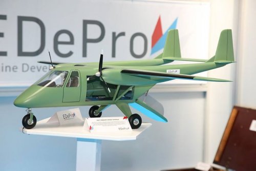

here is a SkyPickup high-wing light transport twin boom Project.
http://defence-blog.com/news/in-serbia-develop-skypickup-light-transport-aircraft.html

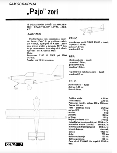

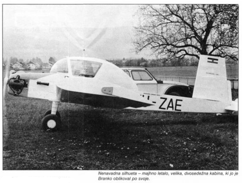

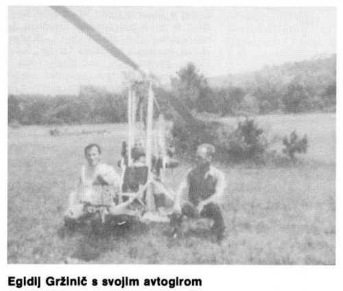

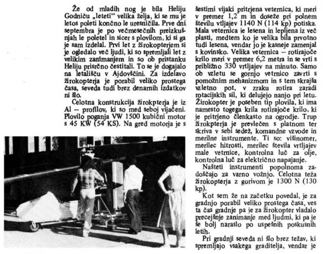

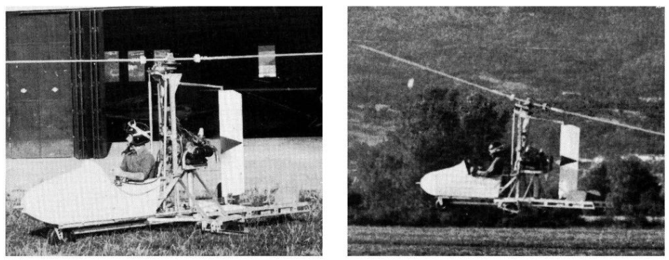

From Krila 1/1984,
here is a Slovenian designer,Egidij Grzinic created an autogiro,and we know by that time it was
under Yugoslavia union,am I right in translate ?,I used google.

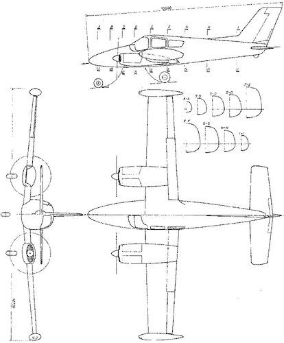

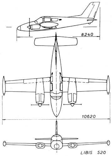

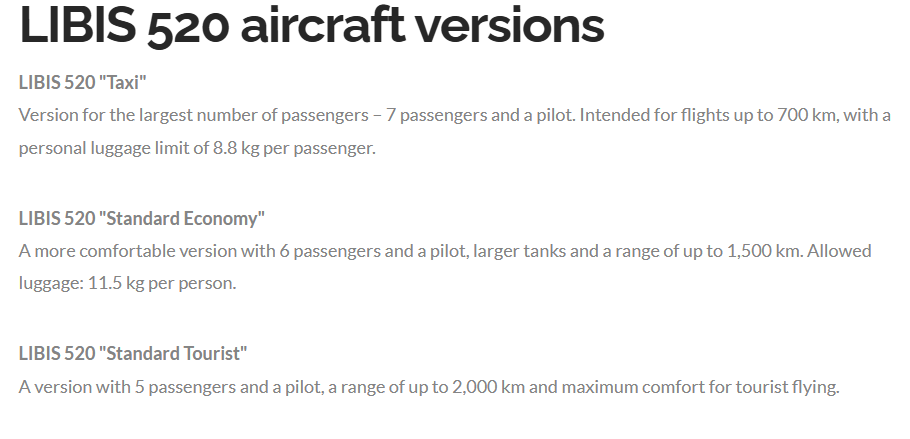

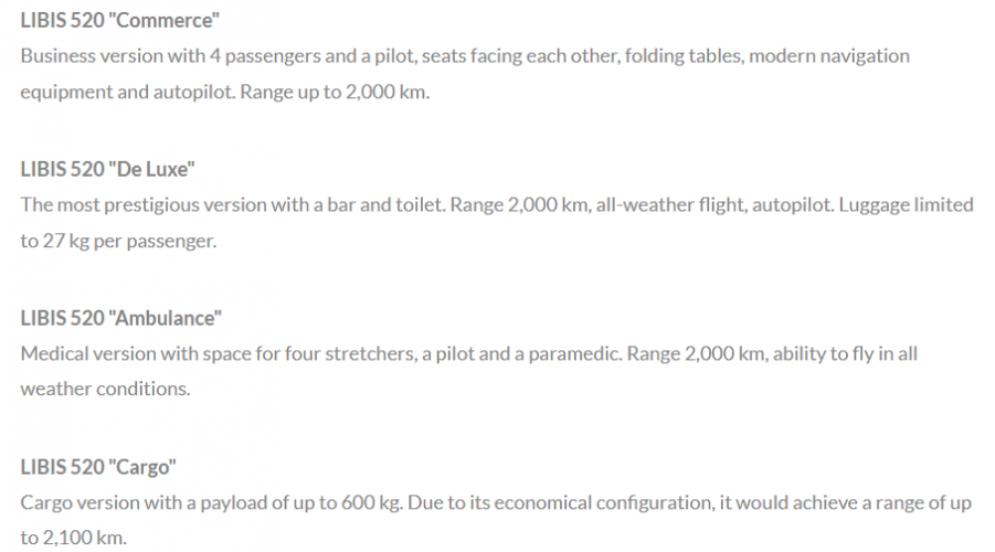

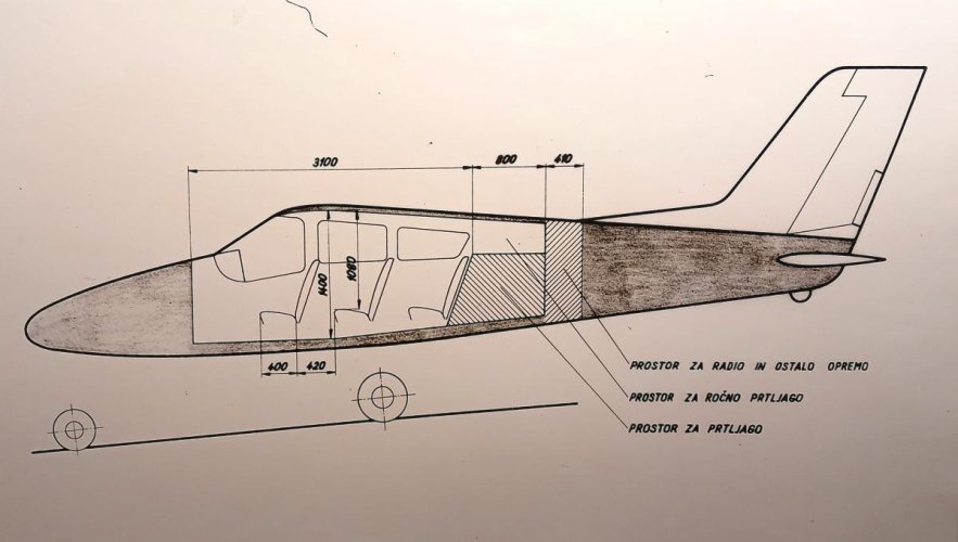

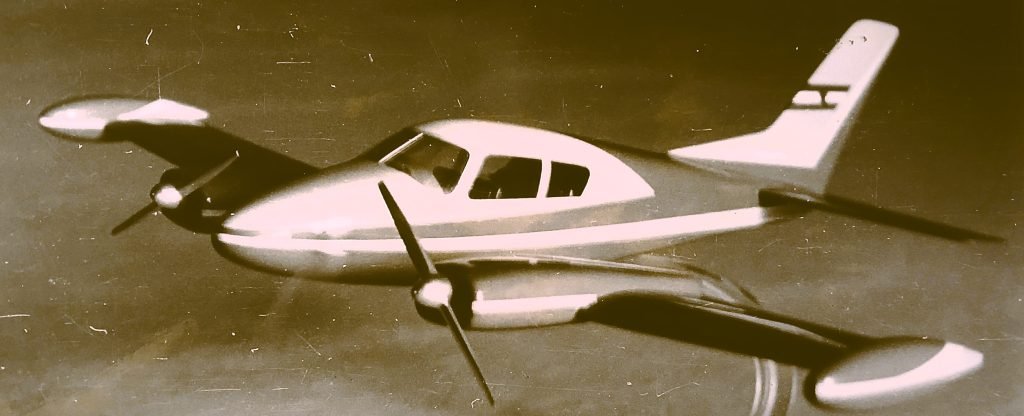

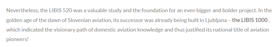

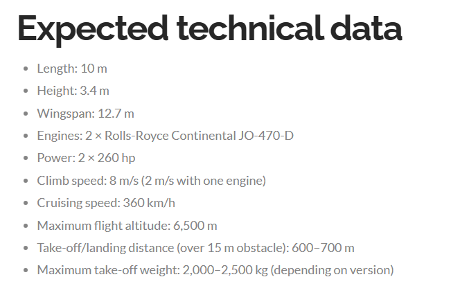

the LIBIS 520 was a twin engined low-wing business monoplane Project of 1956;
