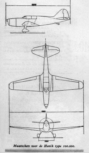

here is the Type 100.000,may be a light aircraft;
http://www.nederlandseluchtvaart.nl/forums/f15-overige-vliegtuigbouwers-other-aircraftmanufacturers/zijn-er-best-wat-349/index6.html

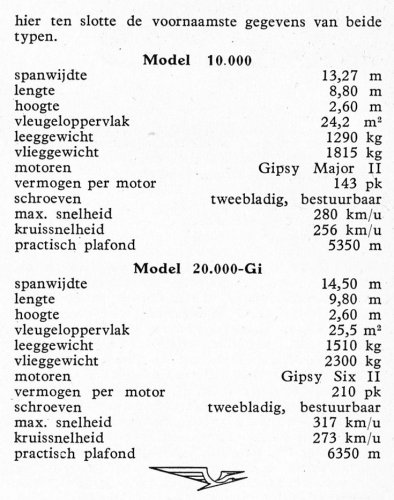

Translation:
People may remember our discussion of two types by 'Van Kuyk Vliegtuigindustrie N.V.' of Leende: type 10.000, a travel- and business aircraft, and type 20.000, a small airliner. We have now received from the same factory - which uses the Havik trademark - the drawing of a third aircraft, printed alongside (type 100.000). This represents a single-engined, two seat, low wing monoplane with a 130hp engine, which shows the same lines as the two types discussed previously and apparently another design by Van Lammeren. To keep realisation as cheap as possible, an attempt has been made to use as many parts from the earlier type 10.000 travel aircraft as possible; this leads to simplification of construction, which eventually is beneficial to price. For instance, the wings are identical to the outer wings of the 10.000; a large number of the type 10.000's fuselage ribs could also be used.
A design for a similar aircraft was already made in 1943, but with side-by-side seating. If any room is to be provided, the aircraft frontal aspect will be fairly wide. A more elegant solution therefore is tandem seating, as the accompanying sketch shows. This last design was made in 1944; both versions should be available in fairly short order.

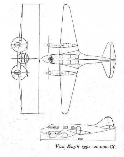

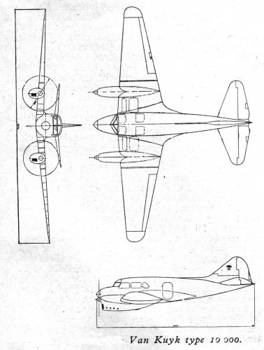

Translation of the text in reply#1:
Sunday, His Excellency the former minister of Water Management, Ir. Tromp, made a visit to the airfield and Van Kuyk Vliegtuigindustrie N.V.
The Leende airfield has a number of small buildings which constitute the new aircraft factory, founded by the manufacturer H. van Kuyk from Tilburg and his son J. van Kuyk. In cooperation with, among others, Ir. T.J.W. van Lammeren work has been going on industriously since 1941 - in secret of course. As soon as early 1942 the airfield was acquired and a hangar built, all in view of the Germans, who never caught on. Interestingly, various official agencies offered clandestine support. Designs produced consisted of a business aircraft, a small airliner, a sports aircraft and six transport aircraft, while the design of a 30-ton aircraft should be at an advanced stage. The main concern are the first mentioned models, whereof a short description. They are the type 10.000, which is the travel- and business aircraft, and the type 20.000-Gi, an airliner for six passengers and a crew of two. The two models have largely similar parts: both wings are similar apart from the tips, the tail surfaces are entirely similar, and the fuselages differ to the extent that the 20.000's one has two more ribs. Both aircraft are of wooden construction, because metal construction, with the required extensive equipment, does not lend itself to limited production. Construction can be started soon, the required material seems to be around, and is only waiting for the building permit. It must be said both designs show a beautiful line; the tail seems somewhat short, related to which the horizontal tail has a fairly large surface. The vertical tail seems somewhat small to us.

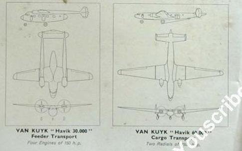

My dear T-50,
it seemed to be that designer had created many aircraft projects,here is the
Type 60.000 shoulder-wing twin engined cargo transport aircraft and the Type
30.000 twin boom high-wing feeder liner aircraft projects.
Source; Inter Avia magazine
http://www.journaux-collection.com/fiche.php?id=594645

I refine the first picture,to be more clearer.

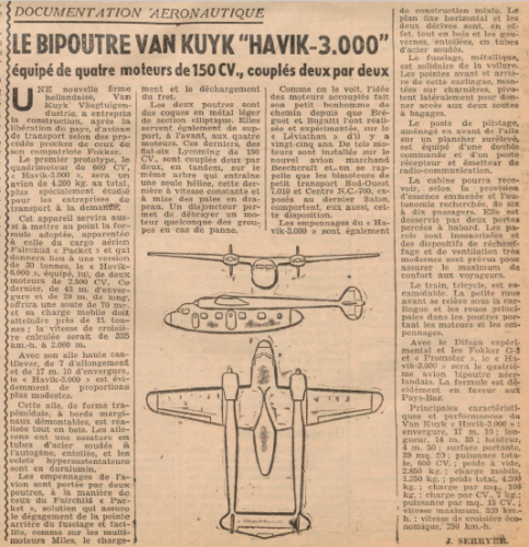

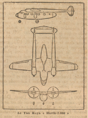

From Ailes 17/1/1948,
here is a Kuyk Type 30.000 aircraft Project,and a small Info about Type 60.000.

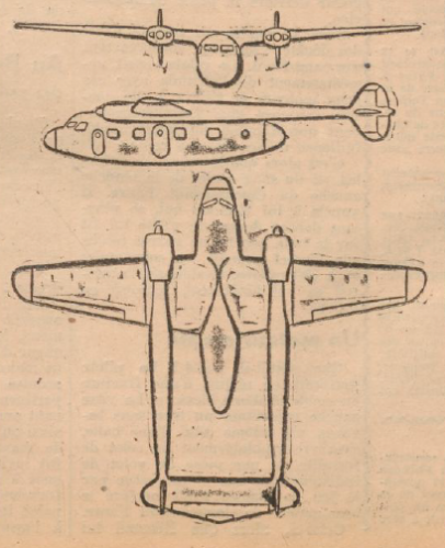

From Aviation Francaise 1947,
a clearer drawing to Type 30.000.

Van Kuyk, various projects 1945
NV Van Kuyk Aircraft Industry in Leende (near Eindhoven) had ambitious plans to build an aircraft industry.
Van Lammeren designed the following projects:
Havik 10,000 A twin-engine light transport aircraft in the Beech D18 class.
Havik 30,000 Also a twin-engine light aircraft intended for 6 to 10 passengers.
It was equipped with two tail booms.
Havik 60,000 A heavy twin-engine transport aircraft with a maximum take-off weight of 30 tons.
