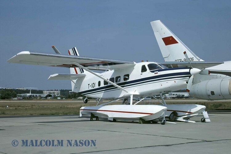

The crazy thing is that shortly after the fall of the USSR the Russians managed to design an An-2 replacement. It was called the T-101. But due to the economic chaos of the 1990's it was never put into production. They simply could have revived that design with a modern engine and updated avionics and put it into production for a fraction of the cost of a clean sheet design. Heck they even developed a float plane version.

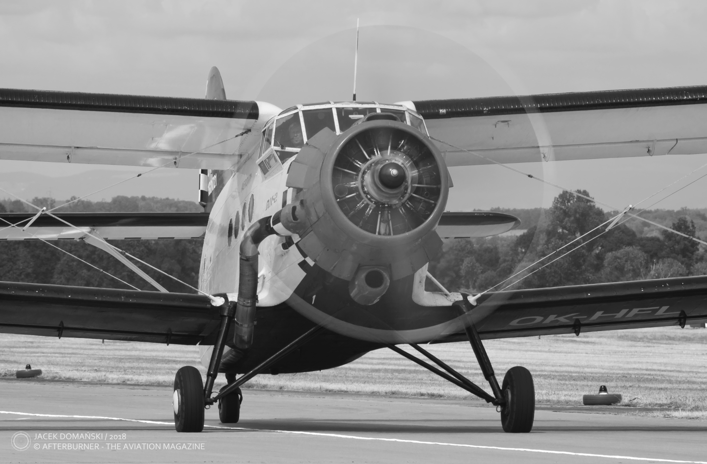

Yes there have been numerous attempts to update Antonov 2 with turboprop engines. The first attempt was back during the 1990s, with a Russian-built engine.
More recently, a Russian company tried to update AN-2 with fancy, curved, composite wings, but they encountered problems with different rates of thermal expansion (aluminum versus composite). From a distance, Ural looks much like its closest Western competitor: Quest Kodiak. The biggest difference is the Ural's tail wheel. LMS 901 will probably lose those fancy, teardrop shaped wheel pants the second time they fill with mud,

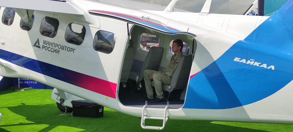

Some more images. I really like the design of the large rear entry door.

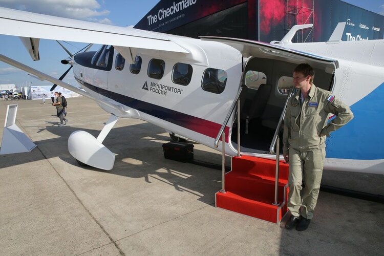

Take off the spats and put bush tires on it.

With 9 seats, it competes directly with Pilatus Porter. We wonder if it can carry as many skydivers as a Cessna Caravan (up to 19), Quest Kodiak (17 ish) or PAC 750 XL (up to 19).
That door looks easier to access, but they need the step to lay flush with the floor for easy skydiving exits.
Finally, will they offer a factory-optional skydiver interior with bob-sled benches and skydiver specific seat-belts (e.g. Hooker tag-lines)?

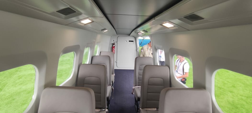

@riggerrob : Cabin size is identical. Published PAX in FAR is 9, perhaps limited to be a class-B aircraft (less stringent category identical to GA).
Identical to what?

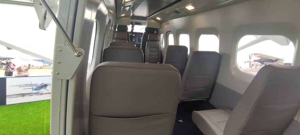

LMS-901 cabin is not as tall as AN-2. IOW It lacks the stand-up room of AN-2.
That cargo door looks similar in size - or smaller - than a Quest Kodiak. Can it even fit a 45 gallon fuel drum?
The cabin also looks narrower than a Cessna 208 Caravan.
In North America, light transports can be certified under more lenient standards if they weight less than 12,500 pounds (about 5,700 kg). I suspect that the ICAO Standard is similar to FAA Part 105.
An-2
Cargo compartment= 13.5 feet long by 5 feet wide by 5.9 feet [1.8m] tall (398.25 cubic feet).
Cargo door opening: 4.5 feet wide by 5 feet tall
LMS-901
cabin height 1.65m
Cargo door (seemingly) 1.5x1.5m
An LD-3 baggage container is 147 cm by 155 cm (aka. 58 by 61 inches = 4 feet 10 inches by 5 feet 1 inch), with a tare weight of 182 pounds and a maximum weight of 3,500 pounds. Thus making the LMS-901 cargo door slightly too low to admit an LD-3 container. If the Russians are smart, they will enlarge the door to allow them to sell to courier companies.
An-2
LMS-901
cabin height 1.65m
An LD-3 baggage container is 147 cm by 155 cm (aka. 58 by 61 inches = 4 feet 10 inches by 5 feet 1 inch), with a tare weight of 82 kg (182 pounds) and a maximum weight of 1,600 kg (3,500 pounds)
This makes the LMS-901 cargo door slightly too low to admit an LD-3 container. If the Russians are smart, they will enlarge the door to allow them to sell to courier companies.
