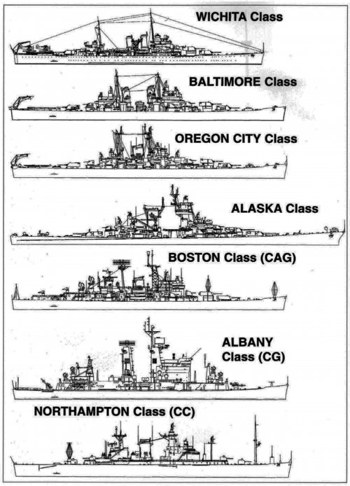

Since the Wichita was about the size of the Brooklyn and Cleveland class CLs, I'm wondering if the final design might have been more like CLG-6 through 8. That might also be consistent with a single launcher that the original poster mentioned.
That said, it is might have been possible to make something more like the CAG-1 and CAG-2 conversion.

That was, AFAIK, the general idea of the CAG-1/2 rebuilds - they were prototypes, so only half the missile battery was installed, leaving them with a gun battery that (while obsolescent) was known to work. A full conversion would have replaced the forward 8-inch turrets as well, but was never carried out.
One of the things learnt from the conversions was that they didn't have enough channels of fire. The additional illuminators were needed, the additional launchers weren't. Which gives the more-or-less standard USN missile ship, with a launcher and two illuminators at each end.

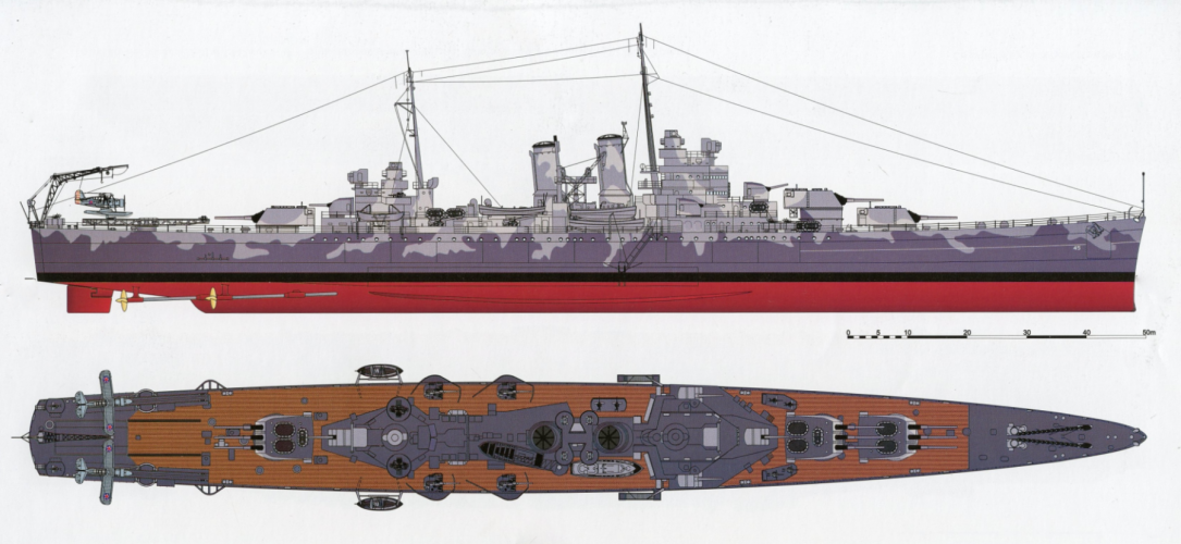

A very interesting idea. Are there any existing design sketches on this proposed conversion?
