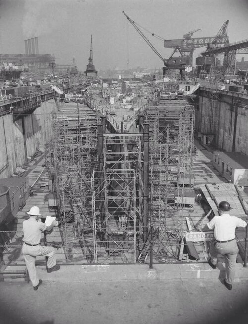

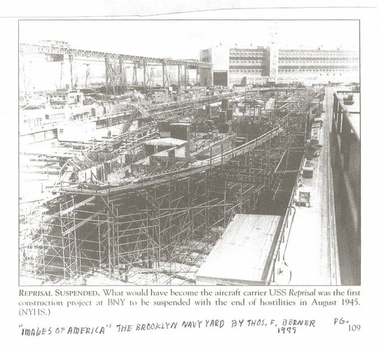

Your launch date for Reprisal is wrong. You have her being launched before being cancelled - and there is no way she was launched in May 1945 (see photos at the bottom).
Oriskany was laid down 1 May 1944, and was launched 13 October 1945.
Reprisal was laid down 1 July 1944 and had not yet been launched when her cancellation order came in on 12 August 1945 (52.3% complete).
Iwo Jima had been laid down on 29 January 1945, and was cancelled the same day as Reprisal.

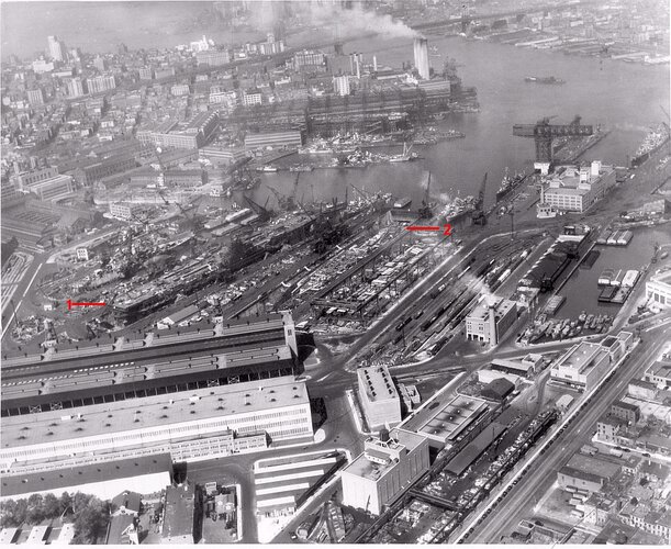

Aerial view of the Brooklyn Navy Yard, BuAer photo # 332720, received 15 April 1945. Refer to NS023502a: (1) Coral Sea, later Franklin D. Roosevelt (CVB-42) under construction in Dry Dock #5; (2) Reprisal (CV-35) under construction in Dry Dock #6.
Naval History and Heritage Command (NHHC) photographs. FDR & Reprisal under construction.jpg
Here is the incomplete hull of Reprisal in August 1945:

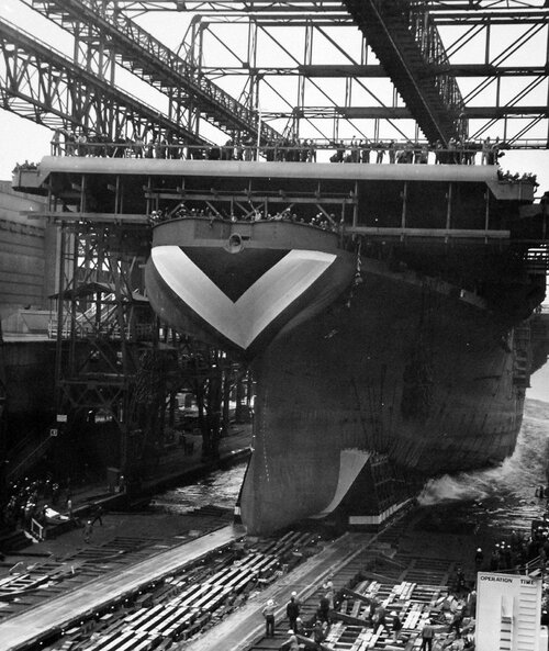

Construction was suspended 22 Aug 1946, when 85% complete. Reordered to a modified design on 8 Aug 1947, torn down to 60% complete, and rebuilt as the SCB-27A design prototype.
Oriskany CV-34 launching at New York Navy Yard New York 13 October 1945:
