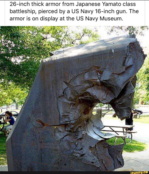

The design board had decided that the then new 2700lb 16in shell was all
that was needed and was only armored against with the Montana. My
question is : was the Yamato shells that much more of a threat than our
16in.
I did some additional research. It's been proven that the 161/50 heavy shell could penetrate the IJN Yamato Class turret face. At long range both the16-inch/50-caliber Mark 7 gun and the IJN 46 cm/45 Type 94 naval gun had similar penetration and performance characteristics. Had that been known and, added to that, the superior speed, fire control, damage control and maneuverability of the U.S. battleship designs, I think the USN Navy would have pressed for the production of the higher speed but equally armored Montana Class derivative beginning with BB-65. Design study of the BB65-8 scheme called or a 33-knot battleship with a standard displacement over 66,000 long tons (67,000 t), waterline length of 1,100 feet (340 m), and required 320,000 shaft horsepower (239 MW). Thoughts?
