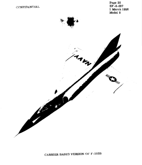

Is there not in Tony Butler's book "American Secret Projects: Fighters & Interceptors 1945-1978" a carrier based F-106 mentioned or even shown as a drawing? :-\ I'm at work now. so I can't look it up.
OK, please correct me, if this topic is about a different program or time period. ;)

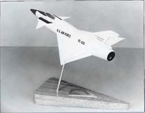

In Mr. Tony Butler's book;
the naval version was powered by J-67 engine,and fitted with additional
canard foreplane,looks like this USAF model.

In Mr. Tony Butler's book,
he mentioned only,there was a carrier-based version,and may be offered to the Navy,
but they refused it.
All work towards a production version of the Sea Dart was abandoned in 1954, two years before the first Delta Dart ever flew.
Although manufacturers will pitch anything to any one, it's hard to believe the Navy would even have the slightest interest in a naval F-106. It would offer them nothing they wouldn't already have.

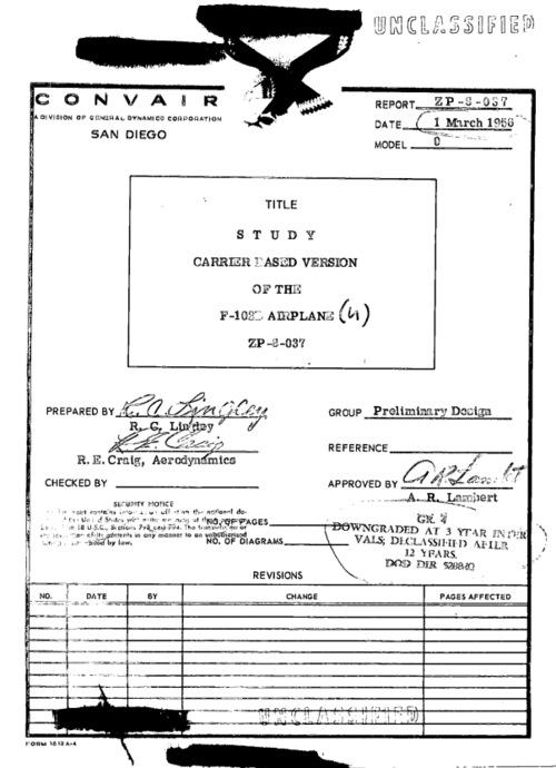

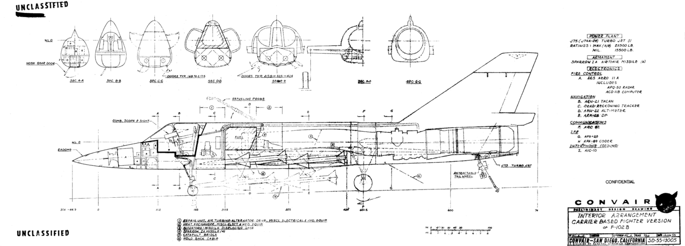

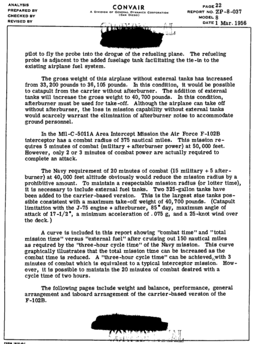

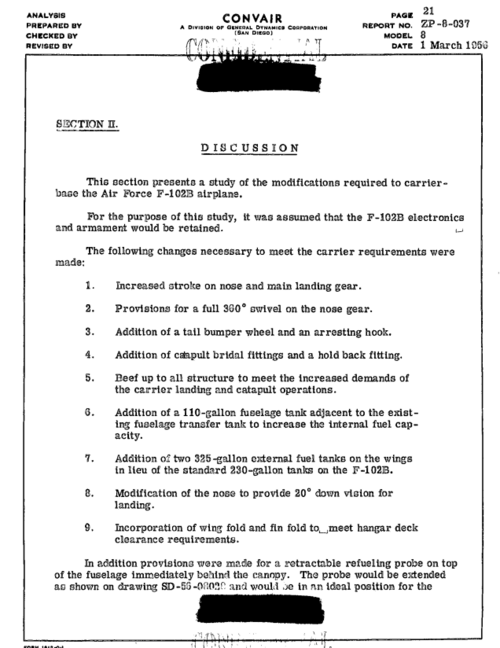

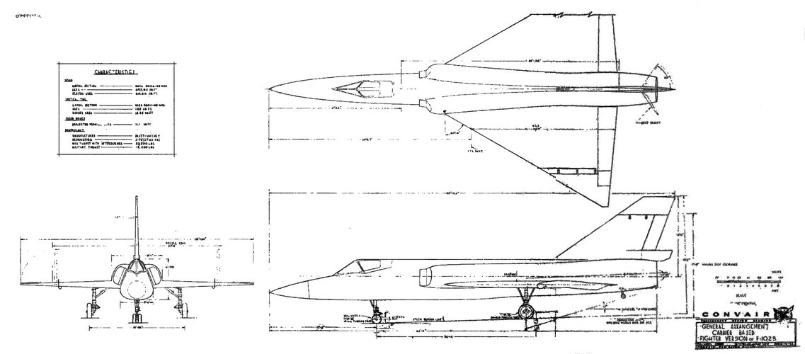

Convair 1956 study for a carrier based F-102B (F-106).
The quad Sparrow carriage is interesting! Given the big fins, not compatible with the later Vulcan mod but could have given the Six a longer life had they not been pushed aside by the F-4. Not convinced it would have made a great Navy plane though...
