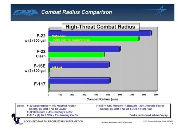

I would think that the NGAD PCA would need to have sufficient combat radius to reach Taiwan while operating from the Second Island Chain installations, which would indicate a combat radius of at least 1,500 nmi, likely with a portion of it in supersonic cruise in order to improve sortie generation and also help with human factors (i.e. mission duration).
Roughly 1,500 nmi with a 'supercruise' requirement would put the NGAD platform at something like 2x the performance of the F-22A when equipped with 2 x 600-gallon tanks. Even with more efficient adaptive engines, you are probably looking at an internal fuel load that's +>50% vs F-22A..perhaps closer to 30,000 lbs?..perhaps something like 50+% more fuel for 100% more range...
There is probably a lot to be gained by modest range extensions even if NGAD is still tanker dependent from the second island chain. Presumably you will need an intact runway to launch from anyway.

Double the range is not marginal. Or did you mean marginally more than even 2x? I'm looking at the cost which has been described to be something like $300 MM a pop by Frank Kendall. depending on what dollar years that is you are somewhere between 30 and 50% above the unit cost of the F-22A in current year dollars which is a constraint that will likely define size / weight and other features..
I just meant even if a 1500 mi combat radius was unachievable for reasonable weight and financial costs, extending to say 1000-1200 mi would still have merit. Also I think the distance from Guam to the center of Taiwan is more like 1700 anyway; I do not think tanker independent operations from the 2nd chain will be practical.
I think a 2x increase over F-22A with tanks is not completely off the books but is not easy either assuming a 30-40% cost increase over inflation adjusted F-22 fly away cost. ACE is something like 38% increase in sub/super range for NGAD over prior gen engines so the aircraft would most certainly have to carry somewhere around 30K lbs of fuel which would be around 30-40% more vs what the YF22 and 23 carried IIRC. It becomes more complicated if you expect it to get there without using those low-drag tanks that the F-22's are testing.
