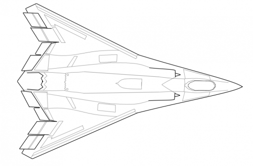

I tried tracing the fighter in the Northrop Grumman advert. Some of the details are not a 100%, and I apologize it isn't really symmetrical in certain aspects, I unfortunately could not get a perfect top view or side view, so simply flipping one side and mirroring it is not an option.
Very nice.

BlastWave said:
I tried tracing the fighter in the Northrop Grumman advert. Some of the details are not a 100%, and I apologize it isn't really asymmetrical in certain aspects, I unfortunately could not get a perfect top view or side view, so simply flipping one side and mirroring it is not an option.
Its uncanny, how much it looks like Mcdonnell Douglas's crank arrow atf circa 1986. All it needs is the wingtip stabs and the canopy on the other side. I scoured the web and can't locate any pics of the wind tunnel model or any of the artwork that was floating around in those days.
Of course this is a single engine concept by NG.

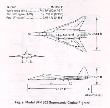

Thinking of these?
A few things... the jagged trailing edge does not appear on other renderings of the Northrop design - artistic license perhaps, to add a bit of visual excitement to a plain silhouette?
Second, the exhaust plumes seem very narrow compared to what one would expect on such a large aircraft. Artistic license again, something about the variable cycle engines?
http://news.usni.org/2014/06/23/next-generation-engine-work-points-future-u-s-fighter-designs
Could indicate the hot inner plume is sheathed in a cold outer flow - or is it just art?
Third, differences between Navy and AF versions. AF version has single, relatively narrow exhaust as noted - could be single engined if we ignore the video presentation? Navy version has ventral inlets and clearly two, wider-spaced engines. Ventral intakes make sense assuming high AoA takeoff and landing on a carrier, and it's known that quite a bit or arm twisting was involved to get them to accept the single-engined F-35 (yes, in the past they've had single-engine planes, but none in recent decades). Reasons for spacing? Efficiencies of packing internal weapons loads within a restricted length, thermal considerations for the flight deck - ie, two spaced plumes scorch less intensely than one big one? Am I over thinking this?

The more I think about the more I think the artist simply looked at what they figured was Northrop's most advanced aircraft out there - the X-47B- saw there was a divider in the nozzle, and figured it would mean there would be two flames in the back. The end.
I just read somewhere that DoD has learned a lesson and F-X and F/A-XX would be different designs specific to USAF and USN needs. However, given how complex and critical to performance next gen variable cycle engines will be, both platforms will have to share a common engine.
While the general planform is likely in the ballpark of what Northrop's considering, it's clear that the advertisement was run by the arts department - you have control surfaces of varying sizes (and more surfaces than you need), fighters pulling Hollywood-inspired maneuvers, X-47Bs flying missions, complete with flight test instrumentation antenna, etc.

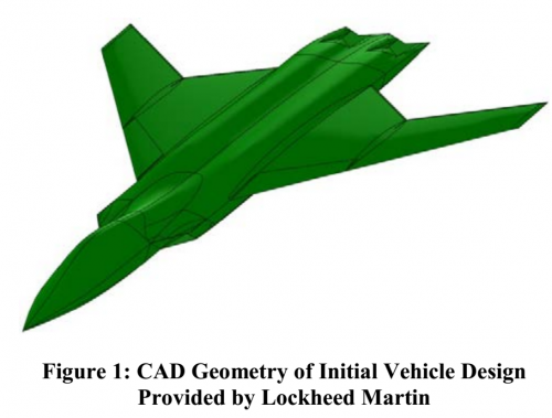

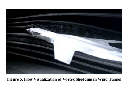

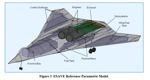

Lockheed Martin's ESAV study
Length: 64 feet
Wingspan: 63 feet
TOGW: 69,000 lb

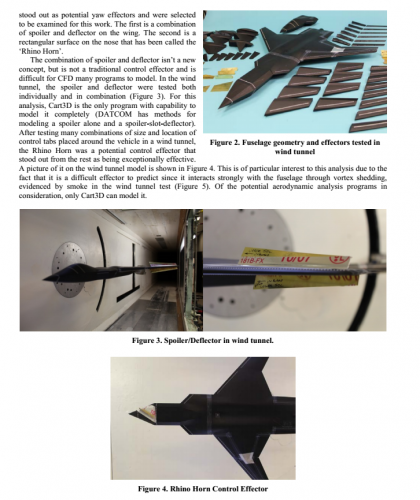

http://arc.aiaa.org/doi/abs/10.2514/6.2015-2324
http://arc.aiaa.org/doi/abs/10.2514/6.2016-0292

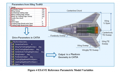

Under the ESAV effort, AFRL awarded NGAD (F-X, F/A-XX) study contracts to LM and NG. Shown below is one of NG's designs that should look familiar.
flateric said:
DrRansom said:
marauder - what ARFL studies?
Yep. That's part of the overall output and those particular papers carry the US Government non-copyright so I feel comfortable with excerpting them.
