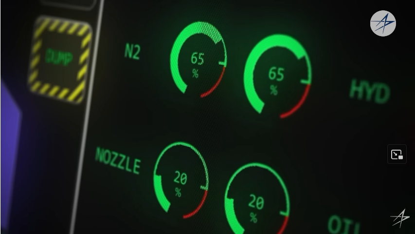

Interesting angle from the latest Lockheed Martin teaser, what do we think is this a V shaped vertical stab? Would love be right about it not being tailless hehe.
I have no idea about the V tail, but it sure looks like there are three engines.........notice three lines of exhaust shocks.
Or rather two exhausts with some overlap due to the angle...
You may be right, but it does appear to be 3 distinct lines of shock diamonds. Anyway, it is just art so who knows except for the artist.

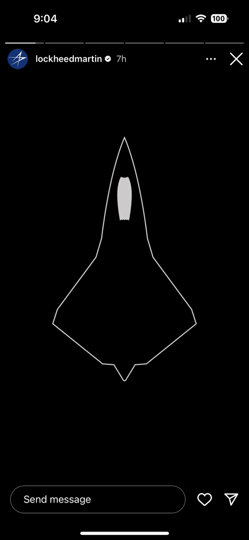

I doubt very much that the LM artwork is anything real.
I tend to agree. However, in this case it is noticeable that the proportions indicate a rather small aircraft and the planform differs from the LM NGAD artwork shown so far.

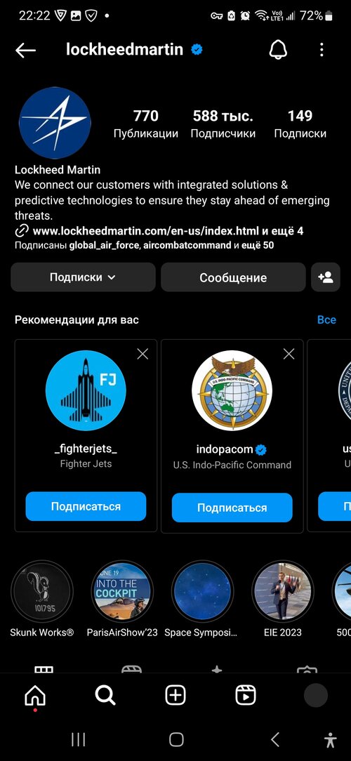

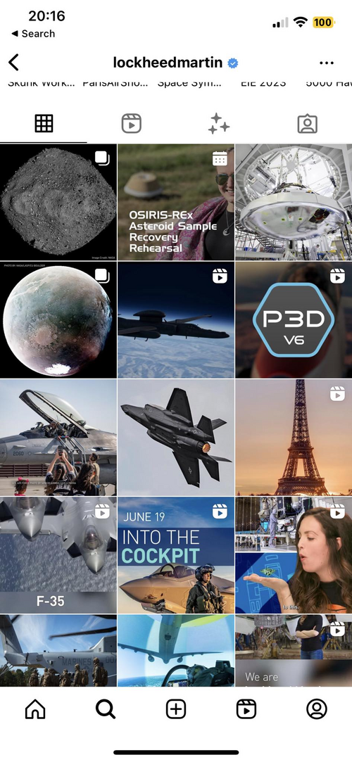

Btw, did you see the story on Instagram? This pic appeared in between other LM planforms, like U-2, F-117, F-22, etc. Could it be a self funded demonstrator, in the likes of SC 401?
It was posted as a story. Storys disappear automatically after a certain time (24h?)

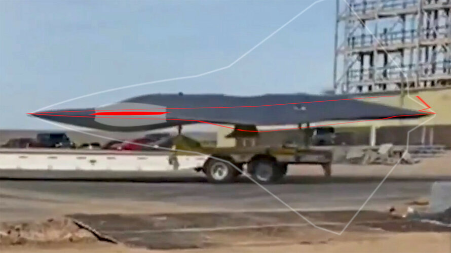

I see some similarities to the thing being carried on the trailer at Helendale a few years ago...

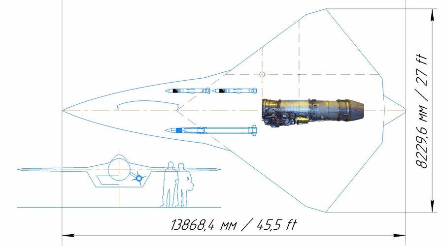

Red outline flattened and inclined to try and match the slanted angle of the camera relative to the model.
the maximum take-off weight is about 10 tons. Combat load 2 - 4 medium-range missiles
engine F414-GE-400

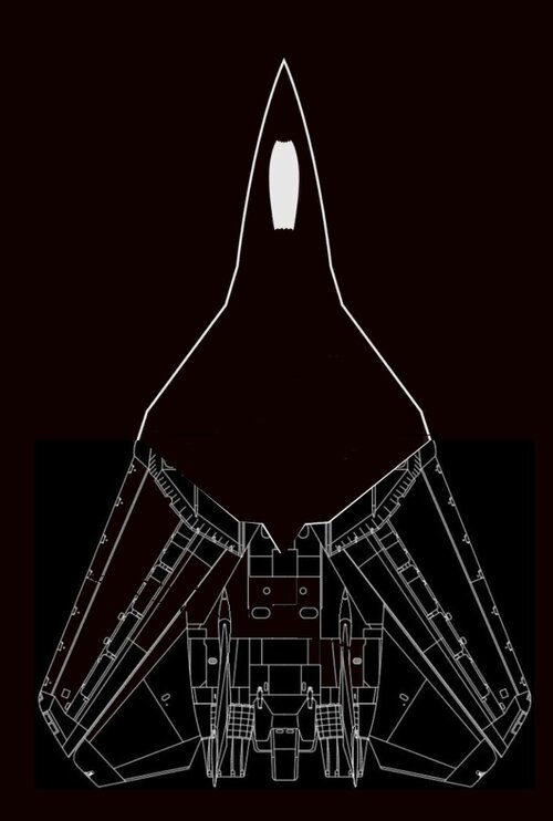

Are you all sure this placeholder art is meant to represent NGAD and not another type of aircraft? They have never specifically stated it. If you removed the awkwardly oversized canopy, with the tail boom the planform would approach SR-72 or Hermeus's Darkhorse hypersonic concepts, implying a much larger airframe than a fighter, important if not two, but three engines are supposed to go inside that thing. Can some members provide insights as to why that decision? Then we have the blue and green lights at the cockpit, And they couldn't have chosen better timing than dusk to go out and film that brief clip of the rear of something. Too many callbacks to Top Gun Maverick IMHO.

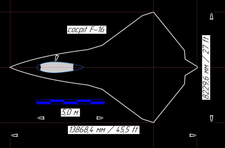

@paralay It's a twin engine aircraft...
NGAD for sure, but I suspect that what Lockheed teased (and was on the trailer at Helendale) is the demonstrator for it.
Paralay's drawing is an estimate probably based on the dimensions of the canopy (correct me if I'm wrong here Paralay).
Edit: to be more clear, what I think is that the demonstrator is way smaller than what the final NGAD will be. The final NGAD proposal will certainly have two engines, but the demonstrator doesn't necessarily need to.
NGAD? A100 or A101, or comparable size (IE, roughly F135 sized!). Maybe a second generation adaptive, using F-22/-35 as test dummies for working the bugs out of the A100 or A101
The conversation is about a light unmanned fighter. For him, two engines are an unacceptable luxury
