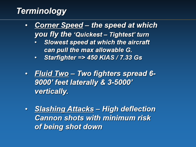

Looker-shooter tactics (1)
Very enlightening. So the F-104 would quite literally finish the Phantom / Sparrow job if "botched". Whatever target escaped the Phantom at medium range, would be ambushed by the more agile Starfighter with Sidewinders and guns. Now that's interesting.

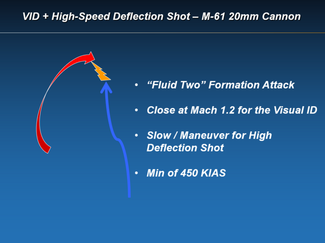

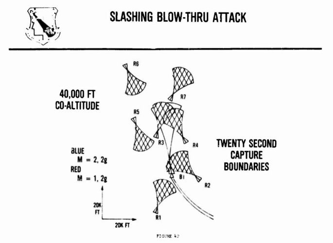

More looker-shooter tactics (2)
There is a limited risk however that a dumb Phantom pilot in the heat of the moment lock his Sparrow on the Starfighter ahead, rather than the MiG to be killed.
I mean, the Starfighter was waiting ahead of the Phantom as quite literally a backup to the (dumbarse) Sparrow: if the Sparrow fails, the Starfighter moves in to kill the Mig in its place. Well, that's a rather interesting "theory" but imagine if the Phantom pilot mistook the Starfighter for the MiG. Ooops !

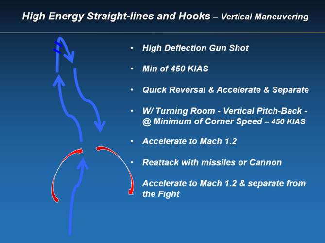

Here is the example of the F-4's hit and run tactics. From the book "One Day in a Long War". This engagement occurred on 10 May 1972.

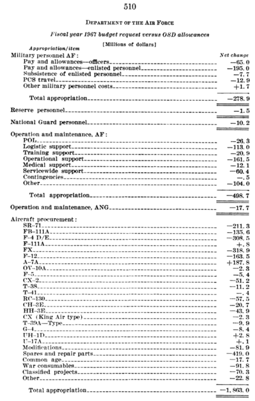

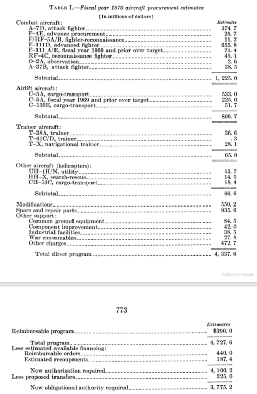

Those interceptors were bought before the Vietnam War.
Two snapshots below show what the USAF were buying in Fiscal Years 1967 and 1970.

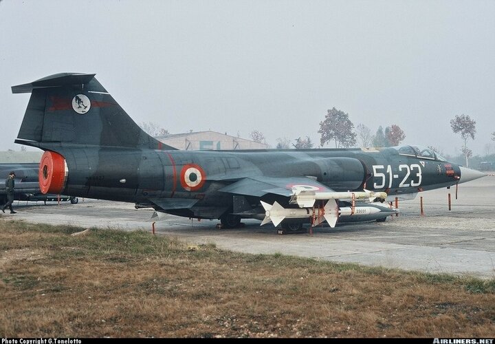

Basically the wings are too small to get Sparrows and Sidewinders and fuel tanks, altogether. Maybe it would better to sacrifice the Sidewinders and go for a combination of gun pod + 2*Sparrows + drop tanks on the wingtips ?

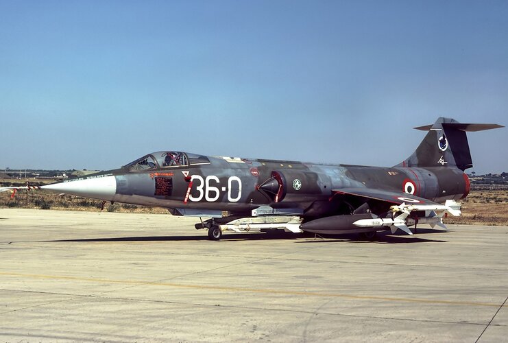

F-104S can carries AIM-9, AIM-7 and drop tank under the wings. They are not too small.
And another 104S showing its three points of armement on the wing.
  • Italian F-104S (51-23, MM6827, 783-1127) of 22Gr, 51St at Treviso - Istrana (11 November 1981).jpg

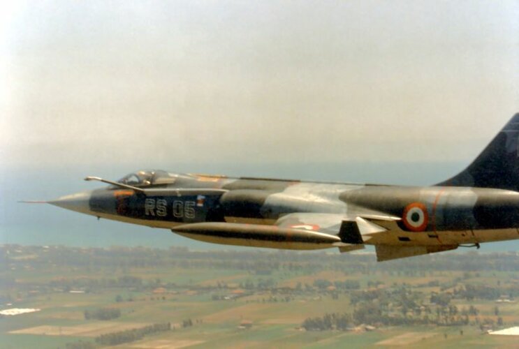

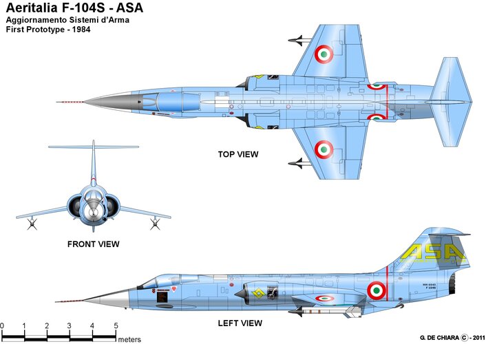

Another problem was that the F-104S lacked of air refuelling capabilities, and it was a big issue taking into account the thirsty nature of the J-79.
Of course the F-104C got a fixed refuelling probe and the F-104S ASA got it also at the end of the 80's when, finally, Italian goverment decided to by 4 Boeing KC-707 for the Italian air force.
But at the end of 60's air refuelling was out of question for Italy, so Aeritalia delivered the F-104S without such capability.
Anyway the fixed probe affected signicatively the F-104's maximum speed.
Do you have pictures of an Italian 104S with a refueling probe ?
Lots of good points there. Spot on for the F-104C, that's what I had in mind, but since you say the fixed probe was kind of draggy... not good for range too. And in Vietnam, you needed a lot of range.
I'd note that F-104 nose was not much different from a Mirage F1, so a similar probe may be feasible (Mirage III just like the 104 never had refueling probe, only much later did the Kfir and Panteras and other south american upgrades got one).
I second that question ! The Internet and Google staunchly refuse to cooperate (for once).
