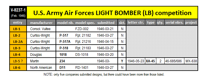

I have attempted to summarize in one single chart all the vital info on the 1946 Light Bomber (LB) competition.
The USAF used the codes LB-1 to LB-6 to designate the various proposals submitted by the five participants.
Although I couldn't find the allocation of "LB-5", it seems logical that it must have been allocated to Martin, the sole winner of the competition. You'll notice that modifications to an initial "LB-" proposal (like Curtiss-Wright's P-517A submitted three weeks after the the initial P-517) received the suffix letter "A", while a clearly distinct design by the same manufacturer (P-518) was allocated a distinct "LB-" number from the start.
The only model number that remains to be identified is that of the Consolidated Vultee Aircraft Corp. proposal (if any was given at all, which is unsure considering CVAC's practice). Martin's design changed radically twice, but retained the original Model 234 designator.
(table removed and replaced by the version in comment #14)
- With respect, title should be U.S. Army Air Force ....
- What does the "V-8237-1" identifier refer to?
- Does "(1946-02)" mean "Second AAF Aircraft Competition of 1946"? (Is this from documentation, or added/created by the researcher?)
- Does the Martin "234 mod" actually fall into the 1947 Light Jet Bomber competition?
Thanks for your comments.
  • "V-8237-1" is the code that is given by several sources to designate that competition.
  • "1946-02" indicates the date of the competition (Feb. 1946) but I do not have the exact date.
  • "234 (mod.)" is not a designation per se, nor was it found as such, it is just a way to indicate a different design. You are absolutely right in stating that it did NOT belong in the initial competition... hence the fact that it is not connected to the "LB-" list on the left. It only derives from the original proposal and was added here to indicate the end result of the competition. I agree that the way it is presented is not crystal clear, I elected to do it this way to reduce the width of the table.
  • With respect, title should be "U.S. Army Air Forces", as the word was plural in the interim 1941-1947 period. Point taken about "Army" missing, though.
I will edit the table accordingly and replace it. Thanks again.
