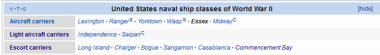

He he... there were scores of small, antiquated and cramped "jeep carriers" in storage since WWII, perhaps 120 of them. 19 kt and 10 000 tons average.
Of the 151 aircraft carriers built in the U.S. during World War II, 122 were escort carriers

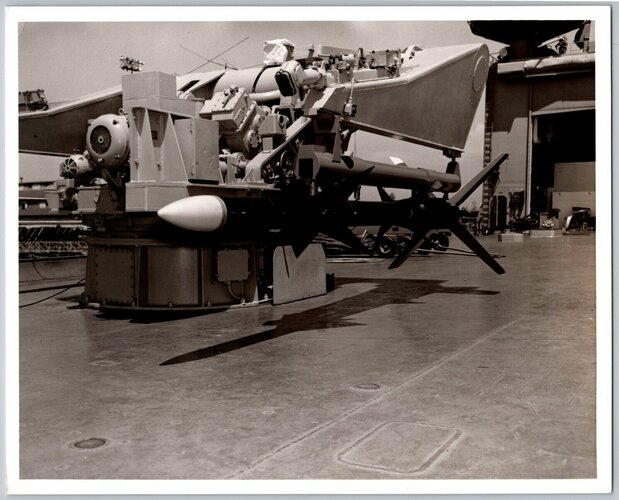

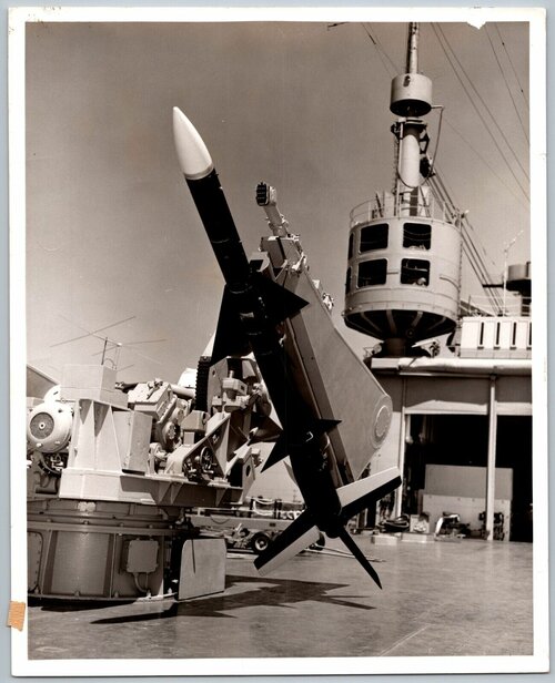

While not Polaris-boosted, here is an obscure boosted Sparrow.
Anyone have any information on it?
