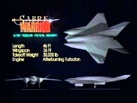

Or this one (albeit LM):

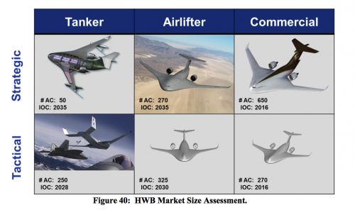

Current technology and diligence would build an max endurance/payload BWB 'complete airplane'. (not a 'flying wing' which is unstable on landing w/ a full tank on a carrier.)
Lockeed calls it a Hybrid Wing Body design.
And NASA estimates there's a market for it in several attractive configurations.
from "Commercial Cargo Derivative Study of the Advanced Hybrid Wing Body Configuration with Over-Wing Engine Nacelles"
https://ntrs.nasa.gov/archive/nasa/casi.ntrs.nasa.gov/20170011487.pdf

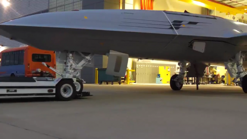

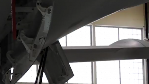

http://www.thedrive.com/the-war-zone/17086/boeing-unveils-prototype-for-the-navys-mq-25-drone-tanker-competition
Upon close examination, there does seem to be a relatively large ventral bay shown directly behind the aircraft's nose gear doors. It isn't clear if this is a large access panel that has been left open or if this is a payload bay of some kind.
Personally, I'm doubtful this is a weapons bay.

Is this a demonstrator (YF-22/X-35) or a true prototype? The YF's had weapon bays. So did Boeing X-45. But again, a tanker with enough room for at least 2 2000lb jdams doesn't "box" unless they build a tanker variant and a strike variant. With F-35C coming along soon is there a pressing need for the USN to also have a LO strike drone? IMHO not really but it would be a thing nice to have.
Wouldn't something intended to open in flight likely have two symmetrical doors, not a big barn door like that.
If it were one big door couldn't it be a rotating bay like the X-51, Buccaneer, or F-101?
sferrin said:
jsport said:
This looks a little more hybrid :). A single Multi-role basis for carriers might also make sense but for fuel alone a genuine 'complete airplane BWB design' would be best.
sure, especially if more fuel volume as it appears. although near vertical surfaces tail a problem.
a FA-XX common standard for ISR, strike, refueler, optionally manned fighter, unmanned fighter escort would be preferable.
jsport said:
Not near vertical, vertical. But given that stealth doesn't appear to be a requirement why would that matter?

The door that The Drive is calling out as a possible future weapons bay is huge and hinged on one side. It's not a rotating bay door.

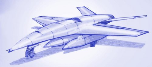

A quick configuration pencil —with F-18 style wings and tanks. Who knows?

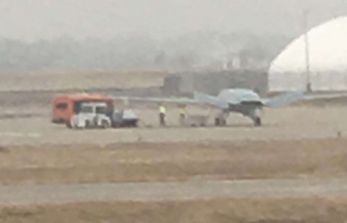

Well I was off a bit on the wingspan, width, wing angle—just about everything. 2nd pass.
I think the real deal is much smaller than your drawing. Small enough that it almost makes me wonder what the point of it is.
sferrin said:
Agree that its smaller than the drawing, but not *that* small. I am guessing from the grainy images over 12klbs and under 15klbs. I have been preoccupied with the real world lately and not following this. If its a tanker then it isn't going to be topping off a couple super hornets at that size. Maybe the point is that isn't a tanker first and foremost and is something else hiding in plain sight. But then why reveal it and tip off the world?

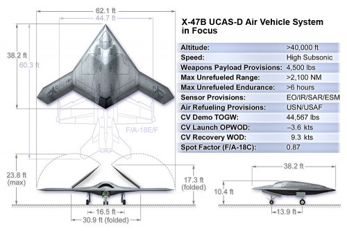

I would guesstimate a wingspan like X-47B and a length close to F-18...

I think your numbers are off. The target that has been quoted as the requirement for CBARS/MQ-25 is 15,000 pounds of fuel "give" at 500nm. That would make the aircraft much heavier than your estimate, unless it's a subscale demonstrator, which seems unlikely.
I'm actually on the demonstrator train, myself. Figure how long do you think Boeing has been assembling this, the date of the requirements changing (again), LockMart saying everyone needs a new design/NG saying enough is enough, apparent size, similarity to early UCLASS artwork; all leads me to believe this isn't their final offering, but something they brought to completion to get their feet wet.

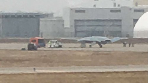

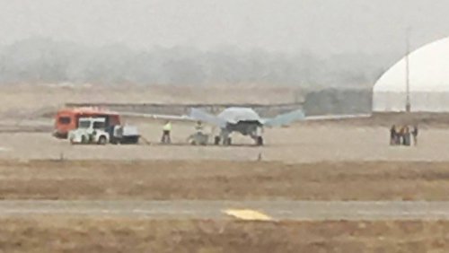

Pretty calm here... Here is some food for speculation :D
I based my sketch on the pictures available so far. As a starting point I chose a wingspan similar to X-47B (18,92 m), what seems to be plausible.The front and side view might be not too far off reality, the planform is pure fantasy, however.

Curiously, I believe they have stated they do not intend to fly this aircraft.
...but the vehicle apparently received a FAA registration number, as reported by FlightGlobal: https://www.flightglobal.com/news/articles/faa-approves-registration-number-for-boeing-mq-25-pr-444627/
"Boeing has received a US aircraft registration for the newly-unveiled demonstrator at the heart of its bid to make up to 72 MQ-25 Stingray carrier-based unmanned tankers for the US Navy, the company confirms to FlightGlobal."
