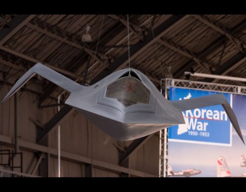

Lots of dihedral on the wings (or maybe partially folded?), and a hint of a 2-D vectoring engine nozzle. I think it's going to be a bit novel. At least it's not another stealth Dorito or flying arrowhead.
Looks very much like Bird of Prey to me given the dihedral - you can just barely see the cover drooping at the far left and right just like BoP as well.
Dual nose wheels. Might it have a nose tow catapult attachment between them? It appears the outer wing panels (the small amount in the photo) have anhedral.
It's definitely a navy program based on the landing gear. It will be interesting to me if the wing configuration is BOP based, as the way the canvas/sheet drapes over it, it looks like wings that are half folded to me. I wonder if this is the classified program the head of Boeing defense systems wouldn't talk about a couple of weeks ago, when reviewing their programs?
Very first thing I thought of. Aft end of a bop planform with maybe a short yf-23 like exhaust.
From LowObservable's post, the image is probably foreshortening the aircraft length by some amount...
My first thought was a Klingon bird of prey, but the i realized that name is already taken by another Boeing.
It looks like the exhaust nozzle is similar to a lot of the nozzles shown on many of their design reports for stealth aircraft that have been shown here (Secret Projects). I think it will be one of their yaw thrust vectoring nozzles. Look at (NASA-CR-4627) IMPACT OF AGILITY REQUIREMENTS ON CONFIGURATION SYNTHESIS (McDonnell-Douglas Aerospace).
