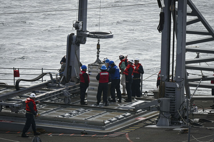

I saw some videos of this system in a demonstration. A couple of questions came to mind. First, you have to remove the used cell liner (that is reused I believe) before loading the new cell liner/missile. What happens to the used liners? Secondly, to remove the old and install the new seems to take about 30+ minutes (at best). This means that to reload 32 cells would take half a day (at least). Thirdly, if you bring across enough reloads, where will you store them during the reload process? You would also have to relocate the transfer rigs to various parts of the ship to work with both the fwd and aft Mk 41's

No, it's a new design. It's a much simpler rigid-boom crane, that is moved on rail trolley (rails placed at sides of Mk-41 launcher). The missile container is pushed into holding rings of crane boom horizontally, then crane is moved toward the empty cell, the boom is erected vertically, and missile container (secured by rings) is lowered into cell.
