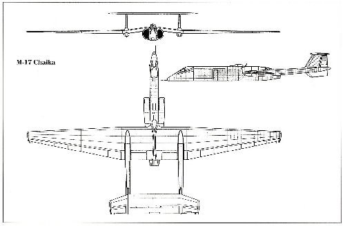

"[myasischev]OKB awarded contract 67 for single seat fighter to destroy CIA high-alt recon balloons. Led by V.M.Myasischev, after his death by Leonid Sokolov...
Kolesov KB produced RD-36-52 engine. TsAGI refined P-173-9 supercritical wing profile. Aircraft subject 34 dubbed (Gull) from inverted gull wing. Armament two AAM plus dorsal turret as on [myasischev] 3M bomber but with GSh-23, 600rds."
also this from
'Soviet X-Planes'...

There is enough clear similarity between the subject 34 & the M-17/M-55 which shows as common design philosophy and indicates that they are a product of the same set of design studies. This I believe. But at the same time they are also clearly very different aircraft.
What I don't understand is the 22 year delay between the end of the balloon flights and the first flight of the Chaika. I find it hard to believe that the M-17 was ever viewed as an interceptor, U-2 flights had stopped (and could be countered by SAMs) and, despite being several times more maneuverable than the U-2/TR-1, it lacked the overall performance required to catch up with it. So, despite the suspicious bulge between the wings, is my assumption that the M-17 (and its successors) were never planned to have an ability to carry armament?
Also, does anyone know where I could get airfoil data, maximum control deflections etc. for modeling this aircraft in X-Plane (or another sim)?

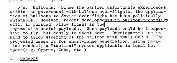

"CEP's?" Does that mean Circular Error Probability? Not sure that's entirely appropriate terminology for an overflight system rather than something that drops right onto a target. I wonder what the steering system was... active propulsion like a blimp seems heavy, maybe it just went up and down in altitude to catch the appropriate winds.
