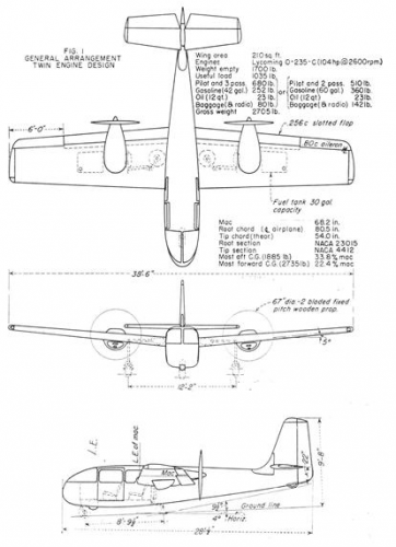

I found this article on Aviation Week 1946,I don't know if it was related to Grumman
or not ?.

Hi Jos :)
I beg to differ and think that the MV-1 was an independent design. Apart from being 4-engined the MV-1 is also dimensionally larger than the Grumman design, which apparently stemmed from the desk of David Thurston, who designed several other Grumman aircraft.
The MV-1 was, as I understand, designed by Mr. Art Turner.
Regards, Walter
Not the same design at all. Similar shape but wrong engines (type and number) and smaller than the Vincent design.
Thurston was working on personal aircraft designs at Grumman in 1946 so it might be one of his designs. The article is actually about the method of performance estimation and doesn't give any proof the design chosen is a Grumman one.

I agree with you my dear Paul.
