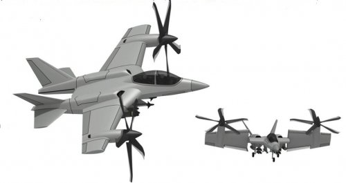

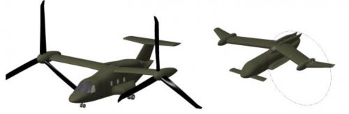

Anyone recognize this Sikorsky tiltwing VTOL concept?
Graham Warwick ‏@TheWoracle Jun 10
AHS Forum 72 special sessions now available @HeloSociety. A teaser: manned tiltwing VTOL variant of @Sikorsky RBW
https://twitter.com/TheWoracle/media
RBW is Rotor-Blown Wing, Sikorsky's tail-sitter concept for the DARPA VTOL X-Plane program. The manned tilt-wing version is new.
http://m.aviationweek.com/blog/sikorskys-rotor-blown-wing-look-familiar
I suspect this might be Sikorsky's musings on a design for that notional USAF AX requirement, assuming it leans a bit more COIN than the A-10. The armament looks like Hellfires, rockets, and Sidewinders.
Concur with Tom.
Army won't do it cause it looks like an aeroplane.
USMC?
yasotay said:
Concur with Tom.
USMC?
Would this breach those silly agreements the Army has with the Air Force to not use armed fixed wing aircraft?
Some thoughts;
One: Yes I do believe that the USAF Inc. will pitch a fit if the Army attempts to get an air vehicle that delivers anything other than ATGM, small rockets and projectiles to targets at ranges greater than say 100 miles. ANYTHING that could risk government funding moving away from their portfolios is a threat. In fairness, all of the services do this.
Two: Army really likes things with big rotors, they have become accustom to that horse. Their fixed wing community is looked on as a circus not to be taken overly seriously. Also the Army is looking at pocket lint trying to find more money to fund existing programs. Another huge aviation program, especially an unsolicited one that might not fit a requirement, is DOA.
Three: The USMC has a stated need to replace the H-1 aircraft in a decade or two (right now that is FVL). Assuming this concept folds up to fit on the assault carrier, it certainly appears to fit nicely within the USMC stated desire to have its VTOL platforms all able to operate at the speed and range of the MV-22. There is also the fact that the USMC has been the only branch to be very successful at acquiring a range of new aircraft in the last ten years. If I were trying to sell an aircraft concept to the Department of Defense, that is where I would go.
Sadly I think this concept, like almost all of the ones on this website, will die due to financial starvation.

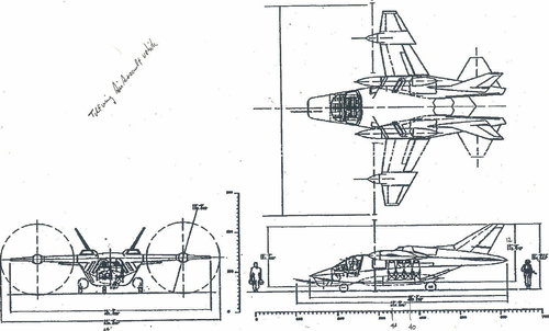

From the Sikorsky briefing at the American Helicopter Society meeting last May.
It is indeed a Sikorsky Tilt Wing. The picture above and the attached splendid pictures from our own CiTrus90 below, are of the transport version that had a crew of 2 or three and room for eight passengers. The design also had a twin seat (tandem) attack version as well. It was developed I am told to a USMC Request for Information in the later 90's as a UH/AH-1 replacement program. Of interest the wings folded back like a Grumman aircraft. The prop-rotor blades folded as well. The number of prop-rotor blades are conjecture.
It was assumed for a long time to be a Bell Tilt Rotor program.
EDIT: Did not realize we had a posted picture of the attack version. Also you can see that it had five prop-rotor blades.
