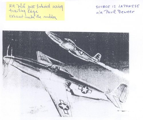

Unknown Jet Mustang
I've seen that same pic in an old Wings or Airpower magazine from the mid to late '70s. I don't recall what the caption may have said other than it was a turbo prop proposal.
Frank, then you think this is a real design. I know that Ed Schmued studied advanced fighters based in the Mustang (others than the widely known negative swept wing and early Sabre ancestors)
Frank ,do you have more info of this
Airpower issue ? (month & year or number)
Thanks.
I have it, tho it's buried deep in storage. I know mid '70s or so & there was a whole series of articles by &/or about, WWII ace "Kit" Carson & it was in one of those issues.
Thanks.
Real or not, I don't know, but I know I've seen the same pic.
I'm curious about the handwritten note, about the exhaust under the rudder. Where did that come from? It's clearly at about the wing trailing edge.
Justo Miranda said:
Unknown japanese source

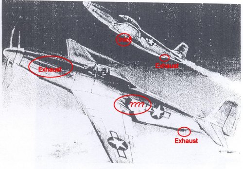

This is my guesswork on what's going on. To me it looks like a mixed-propulsion system... piston with jet.
What the thing on the fuselage side is, I'm uncertain. It's be an unlikely location for jet exhaust... the jet engine or at least the exhaust duct would would be running right through the cockpit. I'd guess it's the jet engine inlet. The inlet on the underside... radiation cooler for the piston engine, I guess.

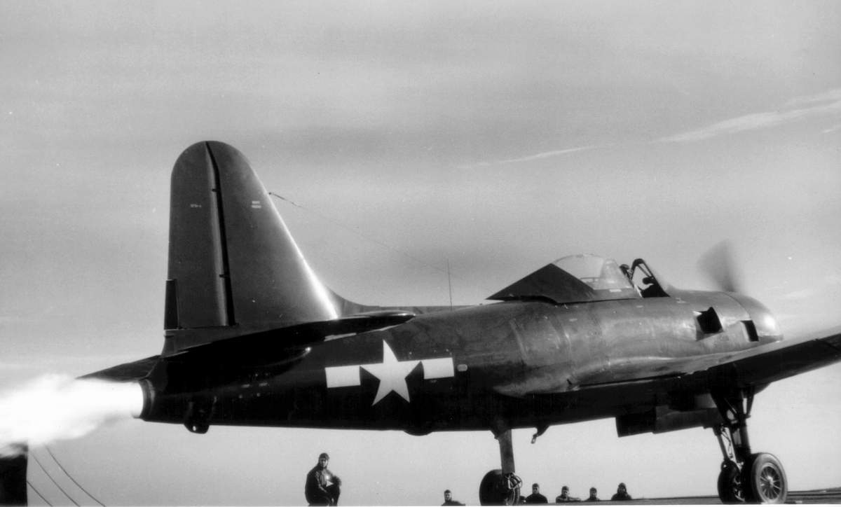

Ryan FR-1 Fireball
Ryan FR-2/3/4, XF2R-1 et XF2R-2

I think this P-51 is one of these study
Ryan FR-1 Fireball in test
IIRC, there was an article by Jared A Zichek (wish he was with this forum) in Air Enthusiast #101 on North American Aviation projects stemming from the P-51 baseline. Do not have the issue but perhaps this was one of the projects.
My thoughts were always that the turbine was mounted behind the cockpit & drove the props thru an extension shaft. The nose housed the gearbox & the inlets are cooling related. The engine, whatever it may have been, was set up like a P & W PT-6. "Backwards". Therefore, the radiator intake is the engine air intake & the exhaust is in the logical location for a PT-6 type of layout.
'Think Frank could be very close...
Nose of this Mustang variant looks to sleek to hold an engine...
This proposal is probably related, as the propulsion system is concerned:
http://www.enginehistory.org/Sarah%20Clark/Finding%20Aid/North%20American%20XP-51Hsw.jpg
I believe this one has always been known as a mixed power Mustang, as it had a piston engine up front & a jet in the back. The other one is what I've seen mentioned only as a turbo prop.

But did the pistons drive the jet or did the jet drive the propeller? 8)

Pave Coin
Cavalier Turbo-Mustang, Piper Enforcer and others
http://www.warbirdsresourcegroup.org/URG/p51.htm
http://www.mustangsmustangs.us/thehangar/index.php?topic=467.msg%25msg_id%25
fredgell
There is a Cavalier Turbo-Mustang at Wright-Patterson and it looks nothing like the drawing. The side air intake looks weird and there is no air intakes at the rear of the wings nor does the exhaust come out the tail.
If I'm not mistaken, the Turbo Mustang at WP is actually the Piper PA-48 Enforcer, which really has little in common with the Cavalier Turbo Mustang III. Other than all designs being turbo prop, I think the pic has no relation to either of the later turbo prop Mustang variants.

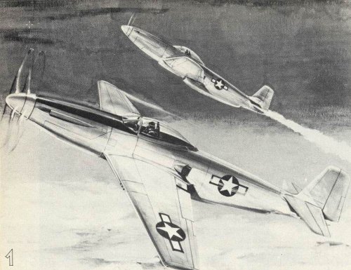

I think I found at last the origins of Justo's drawing and the
magazine mentioned by Frank in his # 1 reply.
The source is :Wings June ,1976 volume 6 no 3
A 14 page article "The Making of the Mustang" part 2- by L.K."Kit" Carson.
The original illustration is on magazine page 20 with the follwing caption:
" Artist's rendition of Turbo-prop version of Mustang, which was in the
preliminary doodling phase at North American but was shelved at the end of the war.
No performance figures are available , but it would have been a 500 mph plus machine
with excellent range and endurence. "
So far the captiontext. I found no further information in the article.
It seems that the contrail streams from the exhaust just above the wing trailing edge at the fuselage wing joint ...

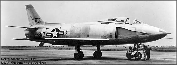

For what its worth, naca did quite a few studies on using submerged ducts as jet engine intakes, most of these studies were with side intakes. Other companies besides naa seemed to have taken up the same idea around the same time.
So the submerged duct inlets on this p-51 lines up with what naca was doing in 45.
With the ultimate expression being the YF-93.

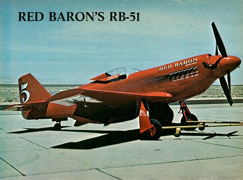

Looks like a counter rotating propulsion system in the drawing similar to the modifications to Reno racing Mustangs after the war.

From lark, I've thankfully got a scan from Wings , June 1976, showing the artist impression
from the first post in better quality. It's described as a turbo-prop version, that was cancelled
with the end of the war.
