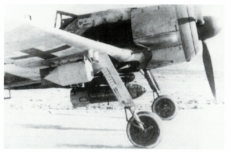

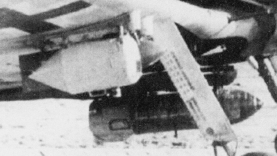

Unknown German bomb
Looks like a field-extemporised piece of ordnance. Don't recall ever seeing anything like it before in any source.

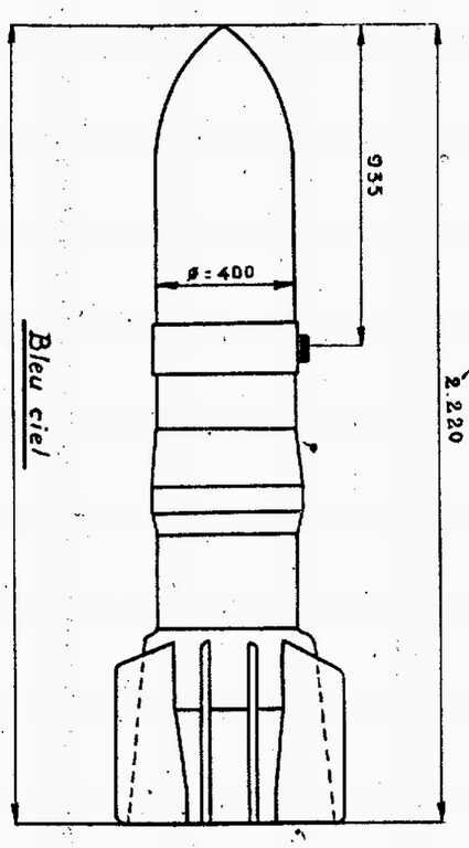

I think that the bomb under the fuselage is a PC1000RS

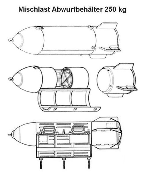

Could the thing on the wing rack be an AB250KZ or MK250LK flare container? Both would have the right stubby look if foreshortened somehow by the camera

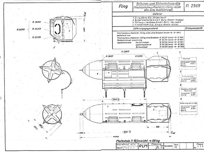

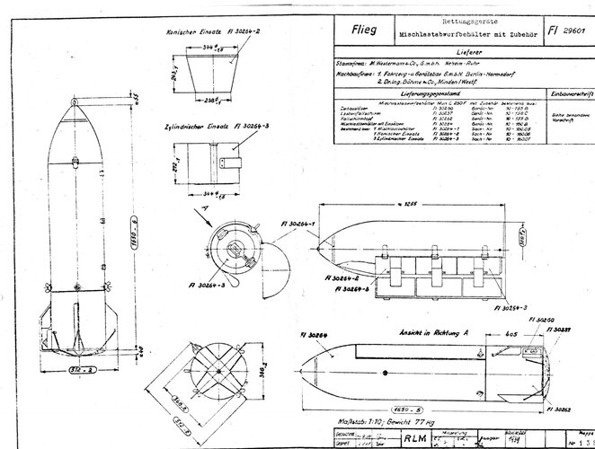

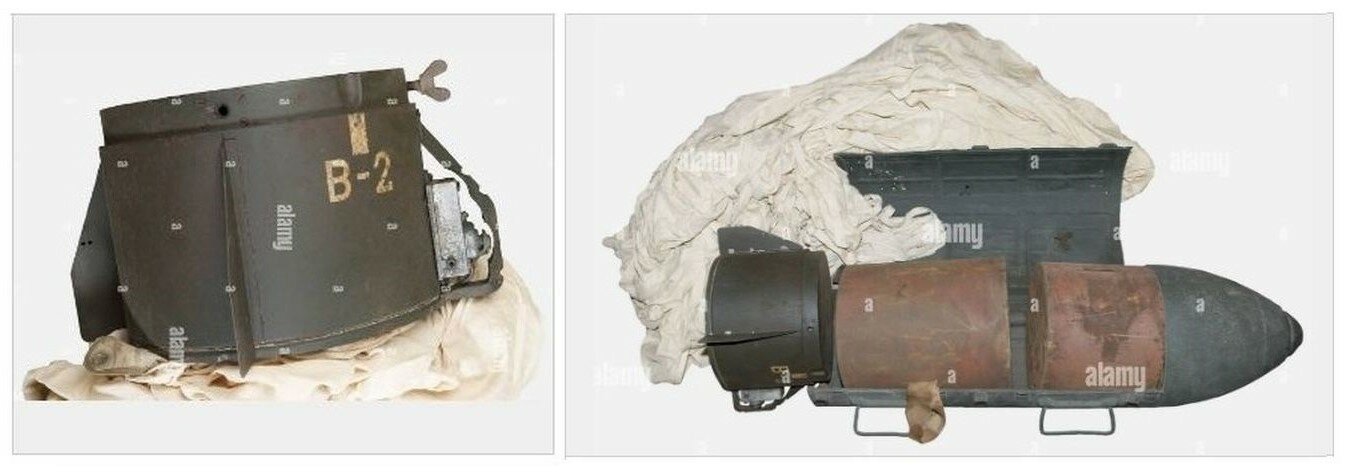

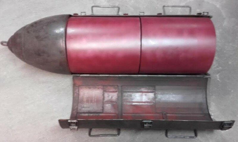

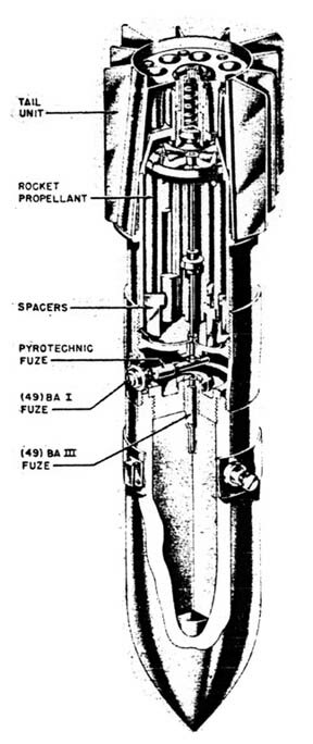

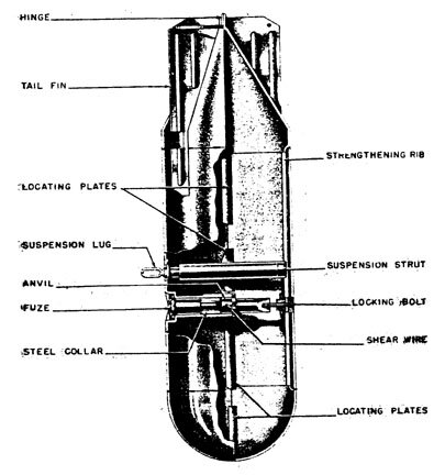

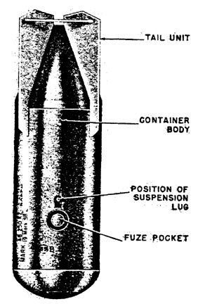

Thanks Grzesio for the identification details on the object under the fuselage, it seems that both objects are containers but there is still the second under the wing which also serves to house an undefined object.

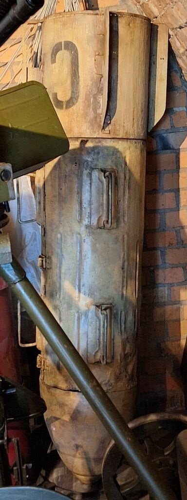

More details.
