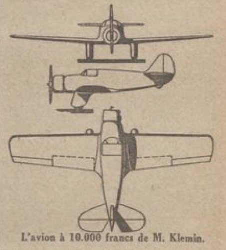

in the Les Ailes journal,USA unknown light aircraft from Alexander Klemin,
famous with his older company; Cox-Klemin,he designed a low-wing light aircraft
during 1930s

Here is the correct link to the article:
http://gallica.bnf.fr/ark:/12148/bpt6k65760288/f5.image
After reading the article thoroughly it appears clearly that Klemin's drawing is nothing more than a hypothetical design for what he thinks an aircraft designed along the lines of Gene Vidal's "$700 airplane" concept should look like. At the end of this very interesting analysis, Klemin concludes: "I believe I have addressed the question in an impartial way. I have no aircraft to sell or any vested interest in any aviation company. I'm only interested in the popularization of flying."
